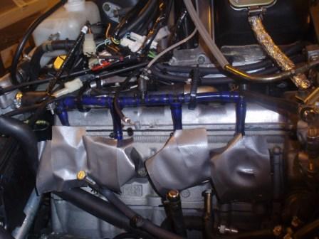

Added some pics of the AN-fittings welded to the plemun chamber of the aribox/intercooler.
It is a tight fit if you have the stock battery and battery tray. You have to remove the plastic cover that goes over the battery to make it fit. I also added some foam/polstery (not sure if it's the right word) to the battery tray. This was done to prevent any rubbing on the battery.

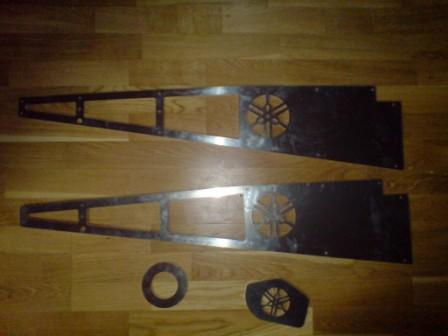

Here is some updates for the summer:
- cr-racing speedometer bracket
- boost and wideband bracket
- tunnel supports (apex mountain tunnel)
- aluminium plate where the speedometer used to go.
Tunnel supports and aluminium plate are self made and cut out on a water jet. If someone need the CAD file after installing a wildchild kit - let me know and I will mail it to you.

That lookd GREAT..would you build more of those speedometer ones and sell one to me???
Thanks, Bull
Thanks, Bull

Cool tuning fork plate to cover up the speedo hole, need one as well
TT
obr and rxrider:
Send me a pm with your email, and I will mail you the CAD-file for the plate and the email address to the company I used.
I have used Grenland mekaniske AS two times to cut ot parts - excellent service.

Obr:
I have e-mailed you the AutoCad file

got it, thanks. I'll look into the oil lines as soon as i start mounting the kit...might be a while, so be patient..LOL
