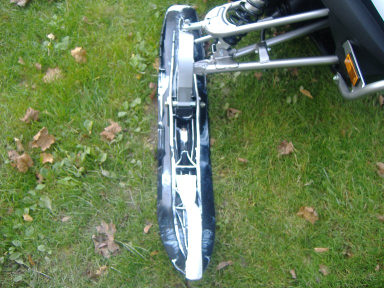

you have to trim out the v part of the rubber intel the spindle fits in and you might need to heat the plastic on the ski to open it up enough to fit the bushings in easier its not much off but on my xtx i put Pilot mountains thats all i had to do heres a pic its not the best pic but i had it in another post click on the pic to enlarge it to see it better but you can kinda see how the plastic on the ski bows out alil thats were the heat gun can into play ;)!

So your modifing the skidoo rubber to fit the nytros spindles? As far as the spindle bushing not fitting, I was going to grind a bit off.
