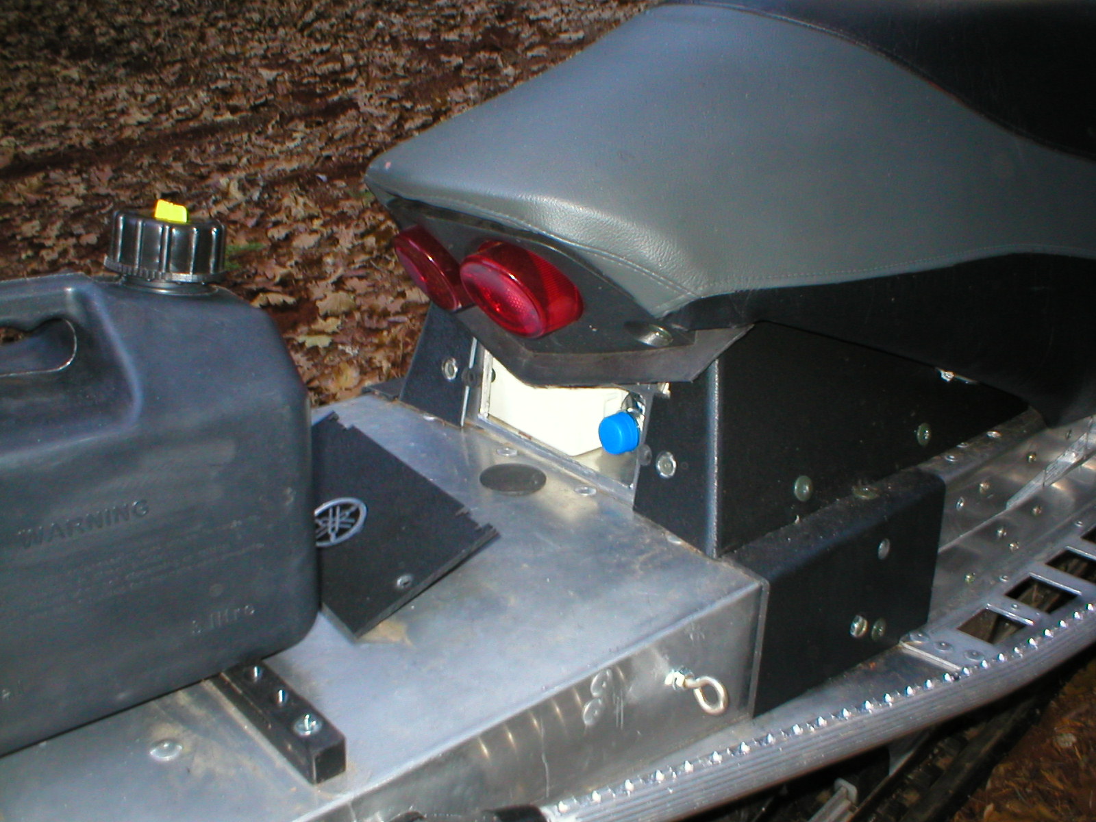

Well, still no freakin' snow here and it is killing me. I did the full Kachess treatment and am DYING to get out and try it. Here is my list and some photos.
Gearing = 19/40
PP Skis
Open boards with board edge coolers and relocated rear cooler
Wildchild rider forward
Speedo relocation to bars
Battery relocation to belly pan
Hartman tunnel extension
159 track
Holz skid
SRX clutching
4" riser
Undertunnel glasspack with CC insert
Trunk
High lift jack
Extra seat and seat jack
Handguards
Barkbuster front suspension
Gas cans - mountain addiction
Grab strap - Powermadd
Rubbermaid airbox
Roll-over oil reservoir
Temp gauge in old handle bar location
Swiss cheese holes behind front shocks for air flow
Headlight and dash removed
Sway bar quick-release
It is all set up so that I don't have to carry a backpack (I don't ride avalanche areas) - all tools, water, jack, base, shovel, survival gear, tow rope, and first aid are carried somewhere on the sled itself.

The board edges are from Fabcraft. The inserts are homemade - huge pain in the neck. I found out after-the-fact that Snow Eliminators offers some for the RX, I would have purchased them if I knew that they existed.
Yes, the tube attached to the airbox is to catch the oil from the crankcase on rollover and then pour it back in the crankcase when righted. Just made it out of some ABS that I had lying around, allows to maintain vacuum to the crankcase, and will hold about 350 ml of oil before overflowing into the airbox. I had a bad rollover while alone last year, sat upside down for about 20 minutes and lost about half a quart into the engine compartment. Made a mess and got some oil on the belt. Did not want to go through that again.
AKrider
Seems like the jack would get ripped off in the first mile?
I like the tupperware airbox. I remember reading about that mod.
Those RX-1's make great project sleds. Seems like you can find them for cheap and then just tear into them to make'em what you want.
bdm
AKrider said:Seems like the jack would get ripped off in the first mile?
I have had it for two seasons and can't think of a way that it would get ripped off.
AKrider
From looking at the photo it appears it would come in contact with the snow during tail landings, wheelies or in a steep transition at the bottom of a hill or ditch. Reason I brought it up is because it sticks out past the snowflap. I continually bent the aluminum snow flap bracket upwards on my Vector, and that's when it was a short track. My flap was always pushed way out from the track.
bdm
AKrider said:From looking at the photo it appears it would come in contact with the snow during tail landings, wheelies or in a steep transition at the bottom of a hill or ditch. Reason I brought it up is because it sticks out past the snowflap. I continually bent the aluminum snow flap bracket upwards on my Vector, and that's when it was a short track. My flap was always pushed way out from the track.
Now I see... I will keep an eye on it and cut off the couple of inches that stick out past the flap if it looks like it might cause a problem.
