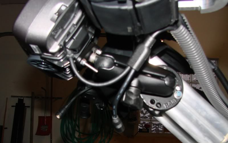

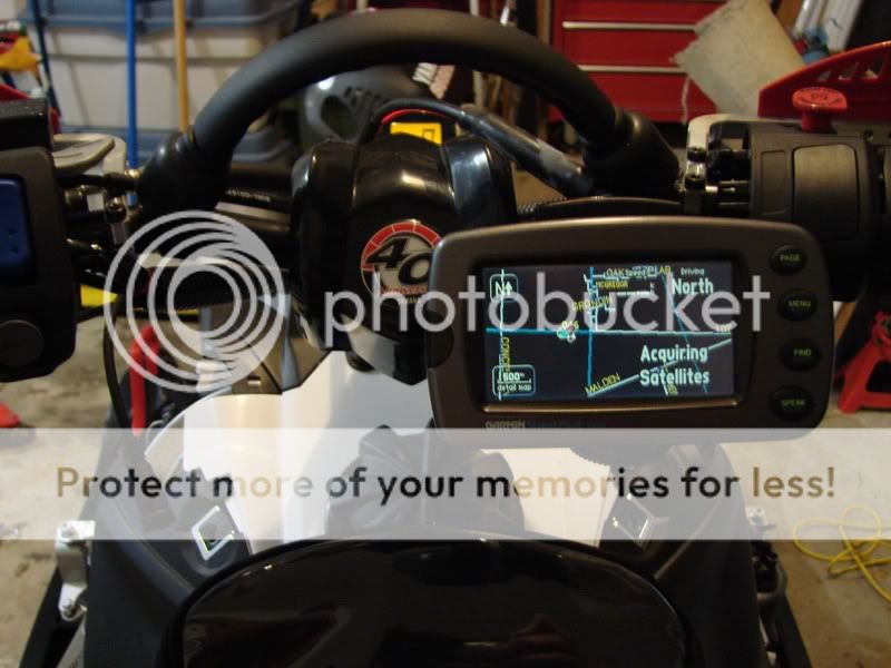

I drilled two holes through the riser and used a bolt with a nut .Mine is mounted on the front so the gps sits up and in front of the pad.
The riser is hollow and I drilled and did the lock nut trick.

I mounted mine so it was offset a little so that it was away from the gas cap, but mines a Nytro. Drilled and tapped.

I also drilled into the riser. I thought that I would have to tap the holes, which I guess would be the proper way to go - but I found that the metal is soft enough that after drilling, the nut sort of "self-tapped" the hole on it's own. I fasted with two lock nuts on the inside.
I've had no issues so far with the mount becoming loose while riding down the trail.
