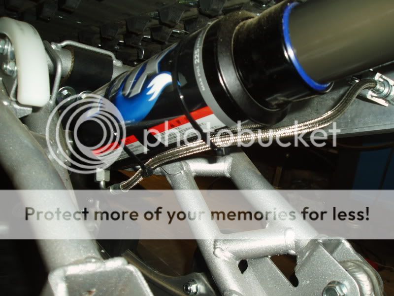

Ulmer Racing will be offering the Mega Float Electronic Pressure Adjustment kit for any Mega Float shock that will bolt into any of the Monoshock rear suspensions.
This kit will eliminate the need for the clumsy hand pump needed for current air pressure adjustments to the shock. The stock air pump assembly requires considerable effort to connect and pump up the rear shock. The Ulmer Racing EPA kit will allow you to easily and endlessly adjust your rear shock pressure for varying day to day conditions.
The current price is set at $395 for the complete kit.
The kit includes:
We will also offer a pre-made panel that has the gauge and air switch assembly already mounted in the panel for less hassle for the end user (you will simply install your DC outlet and key switch assembly into the new panel instead of having to mount the items to your old panel). This kit will be $515.
The kit includes:
- Air Compressor
Mount
Switch Assembly
Gauge Assembly
All lines
All fittings
Braided Stainless Steel Hose
Shock Fitting
Wiring

Will this void the warranty on the shock? If for any reason the system leaks (no pressure in shock) is the sled usable? Manual is pretty specific on how to adjust the shock. I rode one with a blown float and it crashed out bad.
welterracer
That looks awesome allen..
My only concern would that plastic air like on the tunnel getting brittle in the cold and breaking with your foot..

If Yamaha can not prove that it is abuse which broke the shock, then warranty should be no issue at all. We have spoken with Fox engineers who say we should have no problems with the setup at all.
If the system leaks it would be no different than if you blew a seal. Of course it would ride very very rough with no air pressure in it. You would notice instantly if the shock was leaking though as the air pressure on the gauge would begin dropping instantly. If the system is installed correctly you will not have any issues with leaking.
welterracer said:That looks awesome allen..
That plastic air line is way tougher than it looks. It is an industrial line which is used on heavy equipment during the winter, etc and is very very tough to break.

i have a m-20 and the air line along tunnel it has 2 little plastic clamps and they are held with rivots it never comes into play because it's tight against tunnel. no way your foot comes close.
