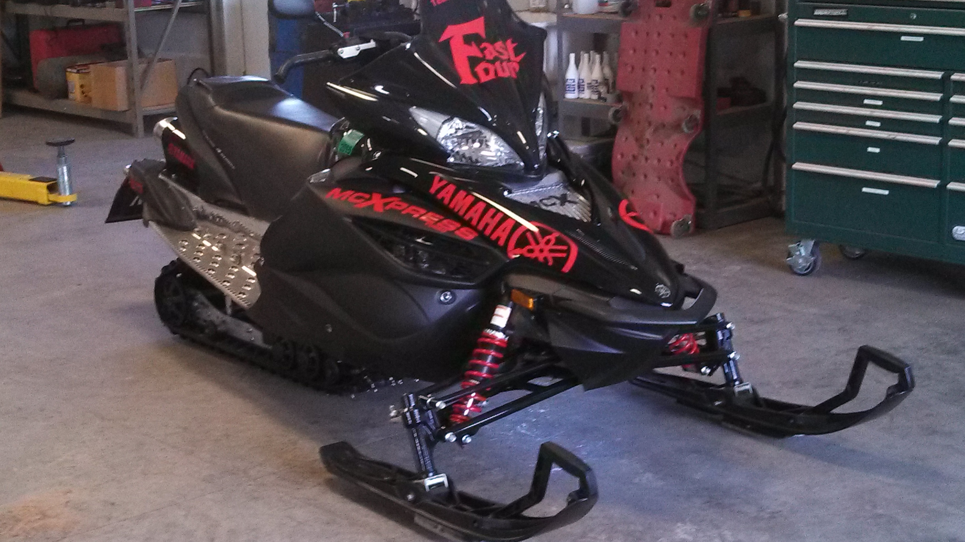

204 studs, and a 128" track. How is the hookup, and cornering? From a side view, it looks like you have a them on the outside and inside?
Yes outside is studded! I concentrate on straight line hook. Every stud is laid out by hand with a 1/8" offset, 2" in center belt is un studded and I use about 1/2" in center of out side belt. I run agressive SnowTracker's so push is not a problem in most condition's. I do a slight grind on the leading face of the stud's as well. It hooks very well for trail stud's! Lots of time!!!
