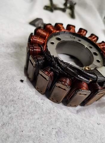

So I have now removed the stator. What a nice 10h job... Not to hard, just so much to remove.
I think I'm just a few things shy of removing the entire engine. I removed the rear engine mount and loosened the fronts to be able to rotate the engine up a few inches.
Anyhow, take a look at this beauty!
- 7,693
Yup. That is cooked.
