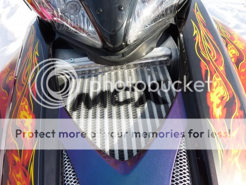

Some pictures of her:

Niceeeeee
le700
Thanks, both rx and tbird

Sweet lookin sled .. What turbo is that ?
rxrider
Jan-Ove Pedersen
- Apr 25, 2003
- 7,355
- 64
- Lakselv - 70N & 25E
- Norway
Mitsubishi TD04-19T
