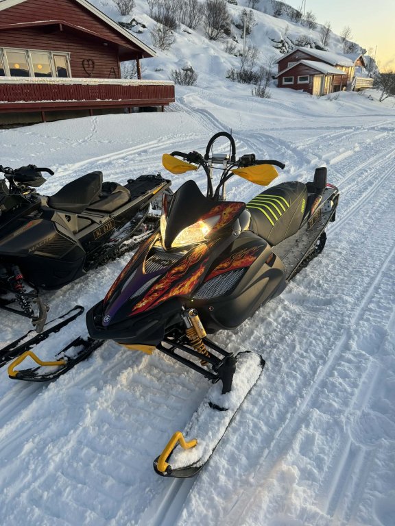

Apex is working fine. Got it back up and running last year. Had it for its first outing this season. It`s a really fun sled to ride. Got some of my other sleds out too. Was a lovely day at the cabin.
