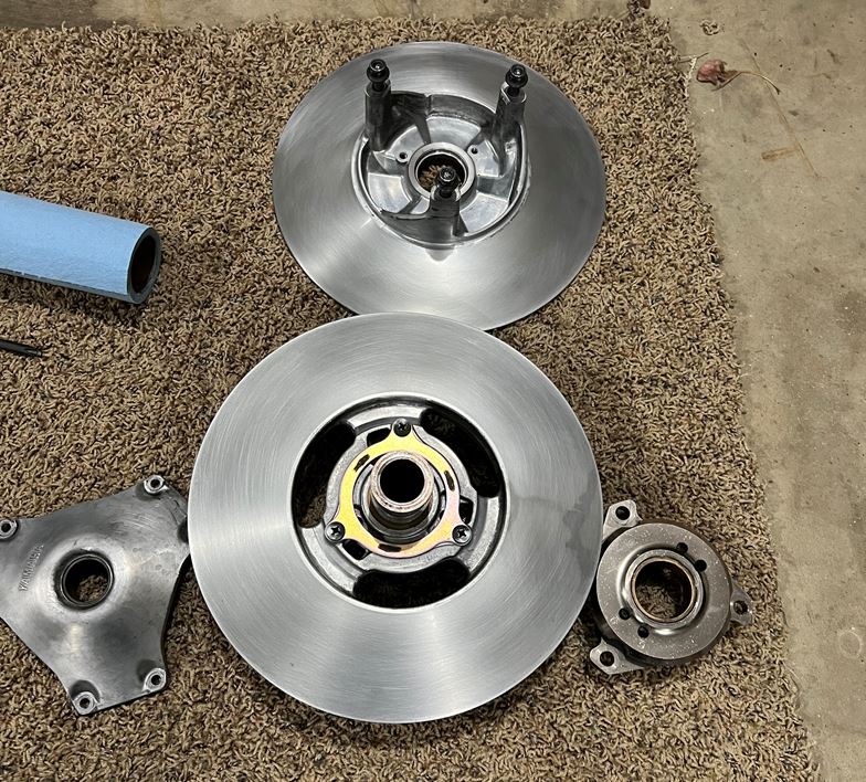

Put a straight edge on the primary sheaves to see how much wear there is about half way up. Don't worry about the grooving near the bottom, it has almost no effect.
The sheave surfaces need to be straight.
I had this same problem on a rs venture years ago and it was excessive wear half way up the sheaves, eating belts like crazy.

There is a definite groove in the center of the primary. So if I get another primary clutch what is the answer so it doesn’t happen again? Not run the 8DN belt something softer?Put a straight edge on the primary sheaves to see how much wear there is about half way up. Don't worry about the grooving near the bottom, it has almost no effect.
- 5,721
- 4,312
Correct.There is a definite groove in the center of the primary. So if I get another primary clutch what is the answer so it doesn’t happen again? Not run the 8DN belt something softer?
I realize everyone is a big fan of the 8dn belt, I used to be also.
However, I came to realize I was wrong. The 8dn is too hard.
Find a clutch with straight sheaves or order new ones. Use the ultimax belt.
I have almost 19000kms on my sidewinder using this belt and my sheaves are straight as new.
