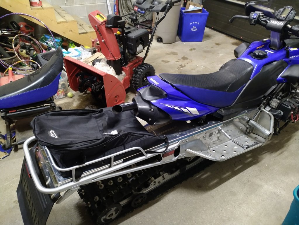

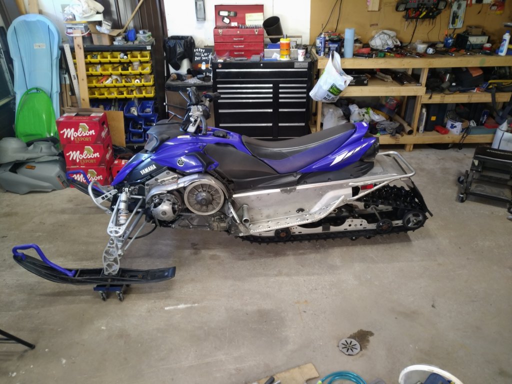

I finally got a good chunk of this project done. Ended up modifying the 08 GT instead as it needed a new track. The 9 tooth drivers did fit but she is a little tight. A little track stretch this winter will definitely help. I have way too many hours into this thing...
As a bonus I found the perfect tunnel bag to fit the new extension at Royal.
I haven't taken it for a rip yet and I am expecting some clutch work ahead of me. I am contemplating a Powerbloc 80 clutch instead of a SBR or other clutch kit. If anyone has any experience with the PB80 I would love to hear about it.
I have uploaded some before and after pics.
