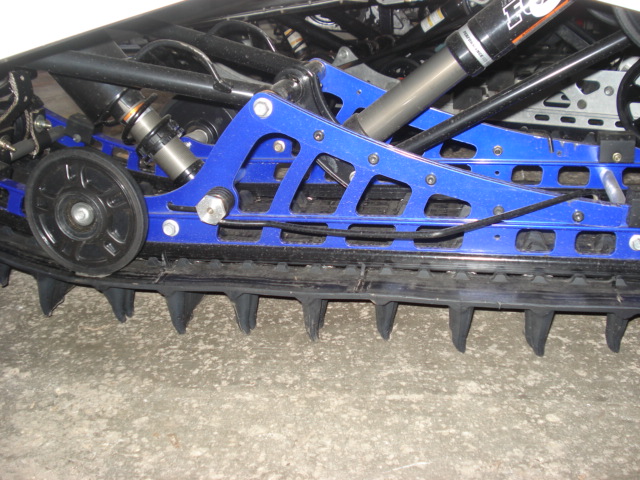

I have a set of blue 153 rails and 153 track coming off my 2015 mtx with only 400 miles.

track is in like new cond. also it would be just the bare rails with slides.

how much are you asking for the track and rails?I have a set of blue 153 rails and 153 track coming off my 2015 mtx with only 400 miles. View attachment 118499
