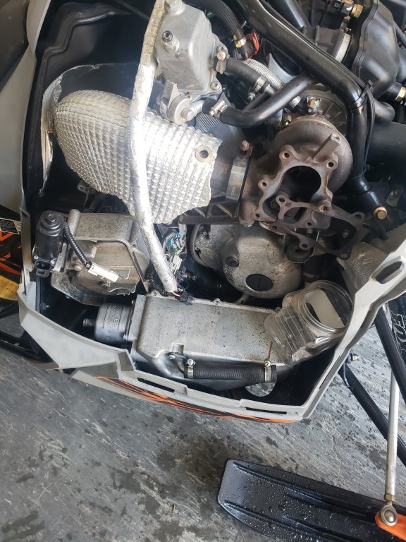

Hey guy I have a sled here that I am working on and the guy want to put a 144 on his 2017 yamaha sidewinder xtx.
For the guys who done the swap did you only swap to
10 tooth 2.52 drivers or did you need to swap to the 8.5 wheel also?
Any info is greatly appreciated
Here are a few pics of the sled I'm working on.
He broke the drive chain and grenade the chaincase.. the sled has 7800km and he said the chaincase never been opened up...lol
He attempted to pull everything apart but I think got overwhelmed or fed up and through everything in the engine bay and dropped it off.
