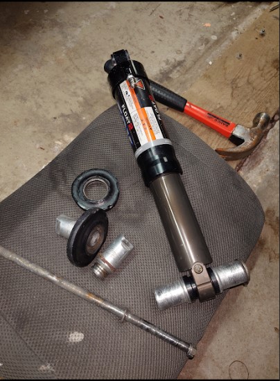

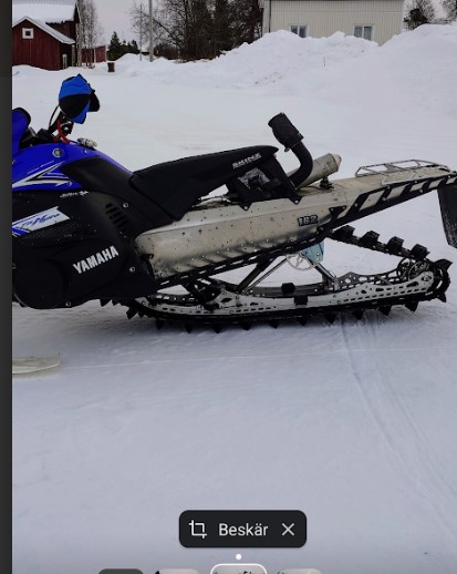

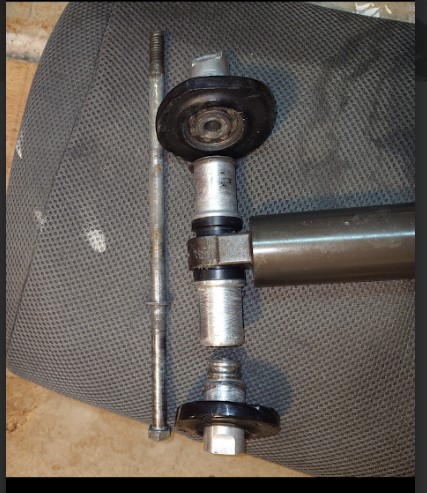

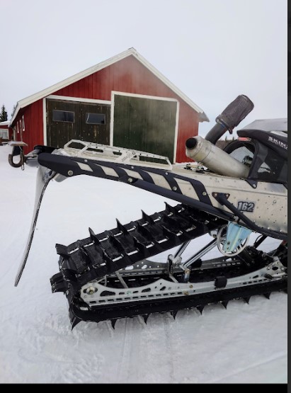

My 162 skid does not look like it have all stock parts. I need to replace the wheels and bearings on the front shock lower axle. It is all ripped apart and i dont now where to start on this. Is anybody recognize this assembly? Wheels are about 65-70mm whats left of it..

That's the Yamaha upgrade kit that was sold as an accessory (uses Arctic Cat arms & geometry). The kit basically replaced the 2 suspension arms, had a new lower mount for the front shock and had a 2 wheel kit for the rear wheels. The kit required you move the front and rear mounting holes. The Yamaha part number for it was SMA-RSUSP-FX-00 from the accessory catalog.

Thank you very much for this information! Do you know if it is possible to buy the parts separately?That's the Yamaha upgrade kit that was sold as an accessory (uses Arctic Cat arms & geometry). The kit basically replaced the 2 suspension arms, had a new lower mount for the front shock and had a 2 wheel kit for the rear wheels. The kit required you move the front and rear mounting holes. The Yamaha part number for it was SMA-RSUSP-FX-00 from the accessory catalog.

Do you think this is the same?
www.bd-xtreme.com
Pro-Lite Series Inner Idler Wheel Kit 2007-19 M Series & X-Fire
Pro-Lite Series Inner Idler Wheel Kit 2007-2019 M Series & X-Fire

I believe it is the same, as I believe BDX made this kit for Yamaha.
