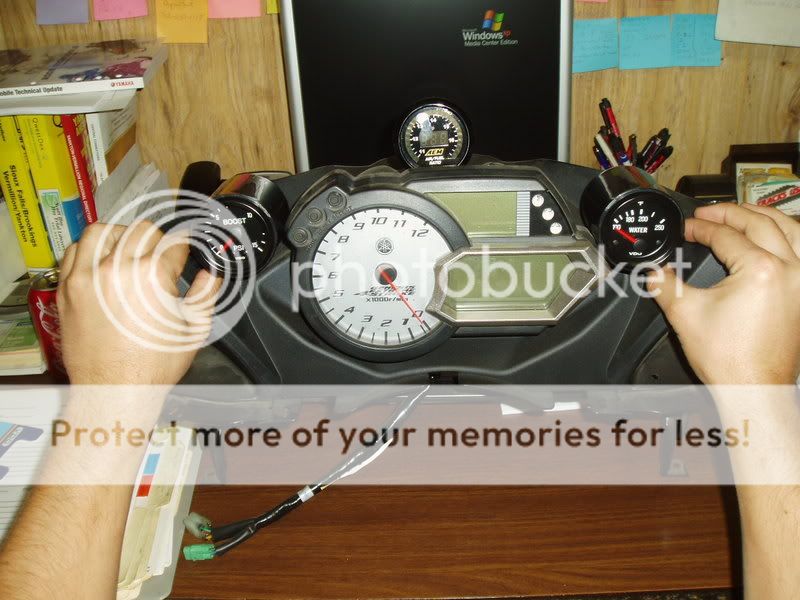

I did get a chance to pick up the gauges needed from Ulmer Racing and 3 single gauge pods for the install at Hay Days. So since I needed to complete the project for this year, me and my brother installed the gauges to monitor and tune the Super Charger. I thought welding the bung onto the exhaust for the Wide Band Fuel was going to be the biggest challenge, but that wasn’t the case, installing the gauges along with routing all the wires and hoses was quite a bit more tedious. I would like to thank Allen once again for being available to answer my questions on the weekend.

The came from Full Power Performance but Ulmer now sells some that are very similar and have better adjustability.

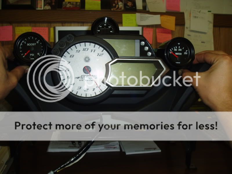

We have a universal mounting kit that comes with a bunch of different bases for mounting depending on how you want to mount it. They also swivel left to right and up and down to accomodate pretty much any mounting position. They are $20 each.
Here is just a few photos of them held up to get an idea on the Apex.
Thanks, any pics of the hood scoop on and off the sled?
