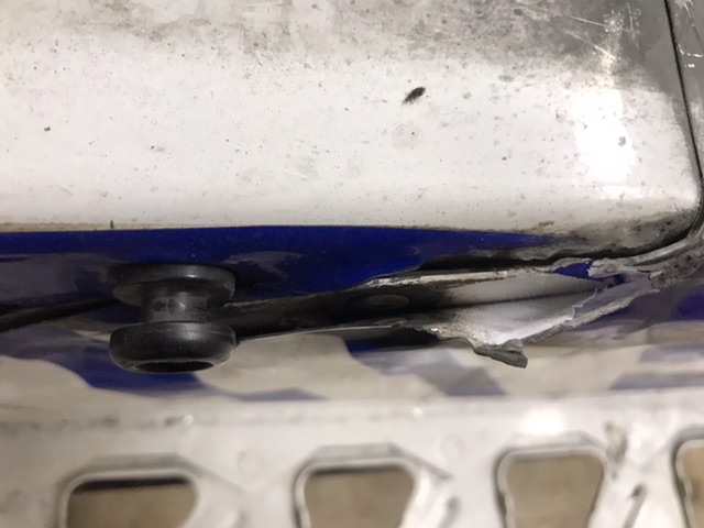

No wonder why replacing the rivets didn’t tighten these up much!

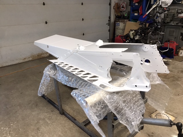

White sure is pretty when new! Will be a wrap going on right away since I hated trying to keep it looking good. Waiting on those rear supports that were broke.
