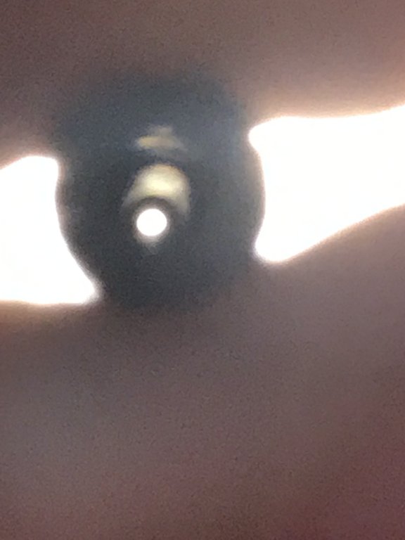

Well I talk with a friend (who works on 2stroke/4stroke bikes as a hobbie) and told him what’s up. He suggested (and I didn’t do it this way) removing the jets (carefully) and carb cleaning them and compressed air one at a time. Now I’m waiting for the Yamaha dealer on a heater assembly for one of the carbs due to me hitting the end just right and breaking the plastic. But so far just from looking at one of the jets (before and after) this may have been the trick
- 21,310
- Age
- 54
Make sure the side hole on the pilots are clean as well. Those are really small.
