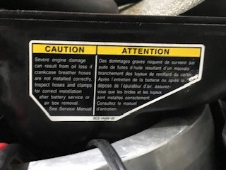

So, got the engine to start, but was not aware that u should not run these without the air box. Engine ran maybe 30 seconds without the airbox, and oil dumped out of the larger hose running from the oil tank breather valve (?) into the end of the air box. Lost probably about a pint or less before I noticed the oil dumping out. Only after looking more closely at the label on the airbox did I notice the small label that said "running engine without all air box hoses connected could lead to severe engine damage" The engine was kind of noisy/rattled sounding when I turned it off. I put the air box back in with all hoses connected, but the motor is still noisy.....
Could I have I have damaged the engine in those 30 seconds before I put the airbox back in?

I believe the warning is for those who run low on oil, which with this little time and low volume of oil I think you will be fine. I am by no means an expert I suspect many more knowledgeable will chime in.

Do you know if you had an oil pressure light on the dash? Most of these 3 cylinder sleds have a real noisy clutch so I would not worry too much if it only ran for 30 seconds. Only way to know is start it up an run it for awhile to get the oil circulating. i would be more worried about dirty jets in the carbs than anything. Make sure you don't just start and shut off a lot especially when it's warm out or you will foul your plugs. Other guys will join in who know more than I do. Good luck!

Exactly, what sxr70001 said........ Clean and sync the carb's and you will be fine! let it warm up until the coolers are hot . The rattle was the clutches .
