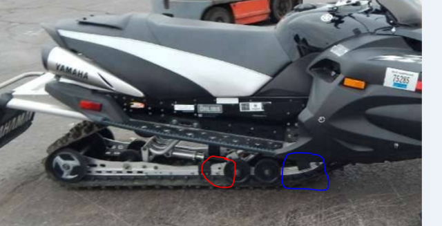

I have a 07' Attak GT. I recently bought a set of cable style ice scratchers. I have read almost every article on here regarding scratchers and still have questions. I want to mount them on the rail and the only logical location is where the 3 pieces meet. Does anyone have a picture on where they have mounted them on their 136" track. Is it ok to drill next to the bolt holding these 3 sections together? How far back has someone installed these and they still work? Thanks!

Here are the two locations that I was originally thinking about. The blue location may be too far forward and there is no place to hook them up if i don't need them. The red location is where the 3 pieces of rail are bolted together. I was hoping to only drill through 1 piece of rail. Also, I don't want to remove any wheels. Thanks!

the red is the general area where people mount them. have you looked into the ski mounts people are doing?

I put my scratchers where the red circle was. Just open up the hole a little and run the bolt thru.
So you drilled through the 3 layers of rail and it was alright? I was hoping someone had chose this location. Did you need to get a longer bolt?
Kevlar55
- Feb 15, 2004
- 55
- 838
- Western Mass.
- 07 Attak.
Yes, I opened the hole just a little and used a longer bolt. Not much longer.So you drilled through the 3 layers of rail and it was alright? I was hoping someone had chose this location. Did you need to get a longer bolt?
