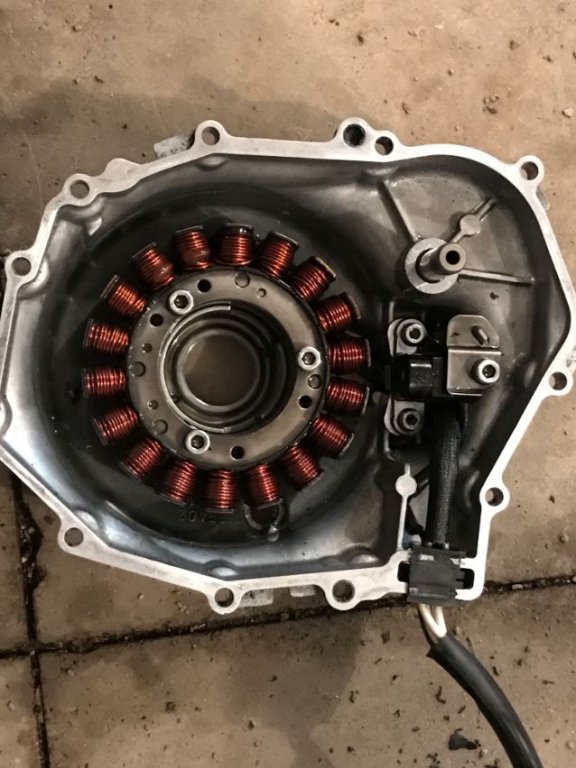

I'm in the process of replacing stator & sensor on my 2007 Apex RTX, unfortunately I took everything apart last spring and can't remember how it goes back together. Hoping you might have any pictures or directions as to where I can find something.I haven't posted anything in a while, but thought I would with this situation. My 2007 Apex RTX with 10k on it threw a code 12 ( crankshaft sensor) the morning after a great ride with it running awesome. It was -8F when I tried to start it and noticed the engine light and code 12 displayed. I figured I would try to the starter relay first as they were known for having bad relays. This did not fix the problem so I am now replacing the stator and sensor with an RM Stator unit. I saw the 2/21/2015 post from ranger1 and plan to follow his instructions. I hope this is the fix and would love some advise or feedback on this topic if possible.

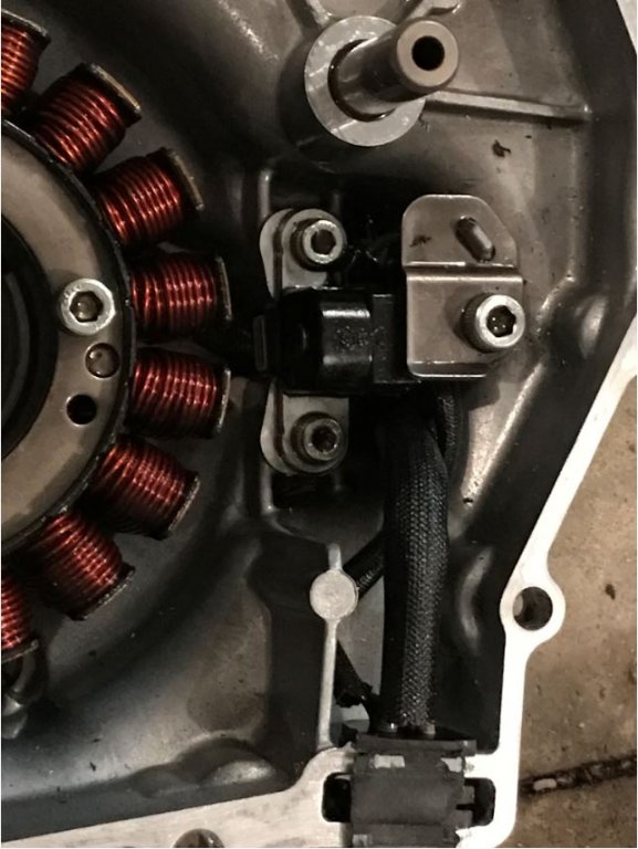

Here you go RickMc... This was from when I had to replace the stator and sensor using OEM parts in 08 Apex:

Great Pics, just what I was looking for.. Thank you!

LOL, I took these pictures when replacing my stator for the exact same reason you're wanting them now, to know how everything goes back together. Glad I hung onto the pics.
