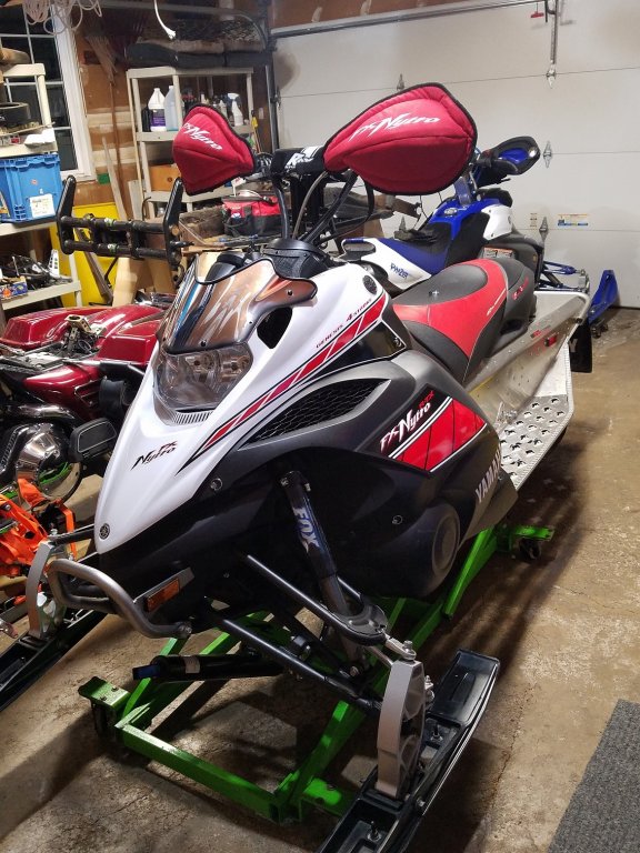

I picked up a 40th Anniversary RTX last year as a project and recently realized that it was missing some of the 40th stripe decals on the nose cone. I am looking for someone who has them on there 40th sled and if you could send me some close up pictures and maybe some measurements that will help position the decals correctly on my sled. I was able to have Kevin at Port get these stickers for me. Some of the 40th stickers are discontinued from Yamaha and no longer available. Thanks, G.B.
My sled w/o the decals
Picture of sled with the decals I am looking to install right behind the front bumper on the nose cone.

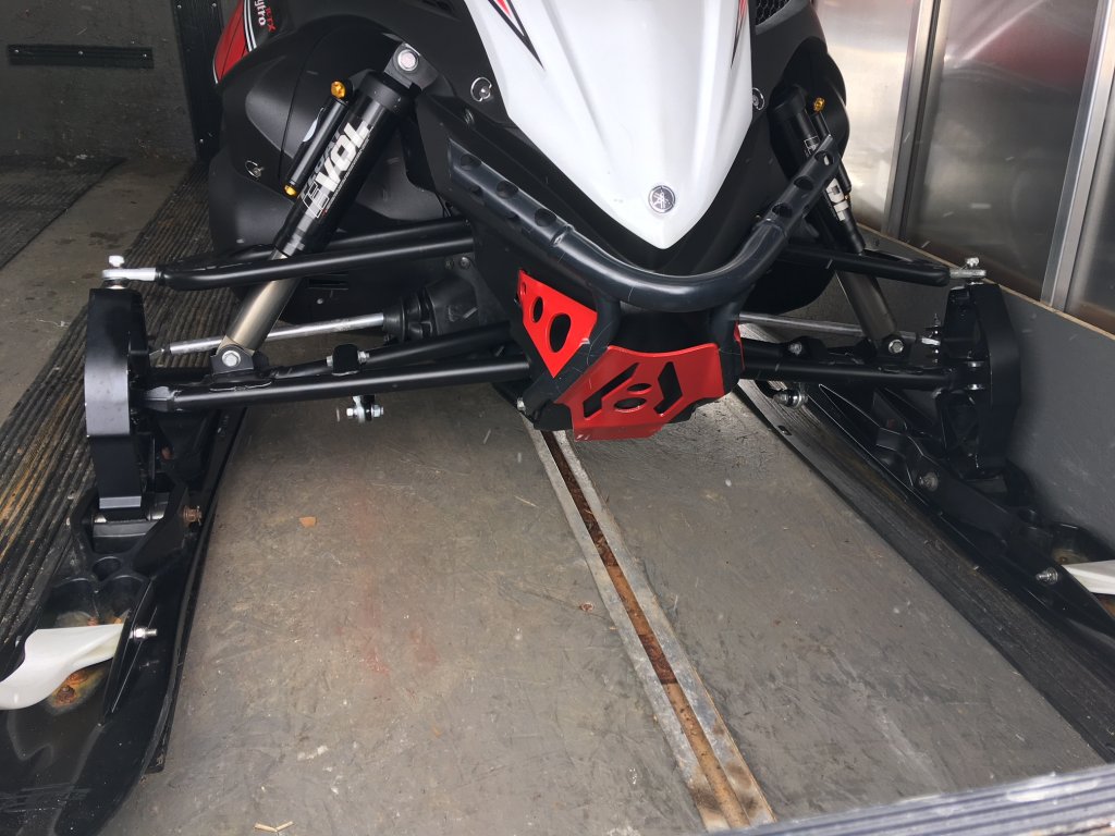

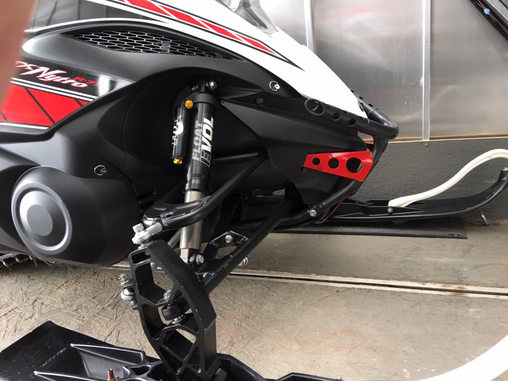

I added some color down there with a two toned front bumper.

Wow, that looks really good Grizz! I like the spindles black as well. G.B.

Just painted the spindles because I didn't want to take a chance on weakening them with the powder coat procedure. The gray just didn't work with those colors.

Yeah, I have read about how powder coating high strength aluminum parts is not good. Thanks, G.B.Just painted the spindles because I didn't want to take a chance on weakening them with the powder coat procedure. The gray just didn't work with those colors.

I never heard that about powder coating and powder coated mine this year, tweaked both! Bought 2013 black spindles to replace them.

I think what happens is that the stock spindles are heat treated and the post bake after powder coating tempers the spindles and reduces their strength. G.B.I never heard that about powder coating and powder coated mine this year, tweaked both! Bought 2013 black spindles to replace them.

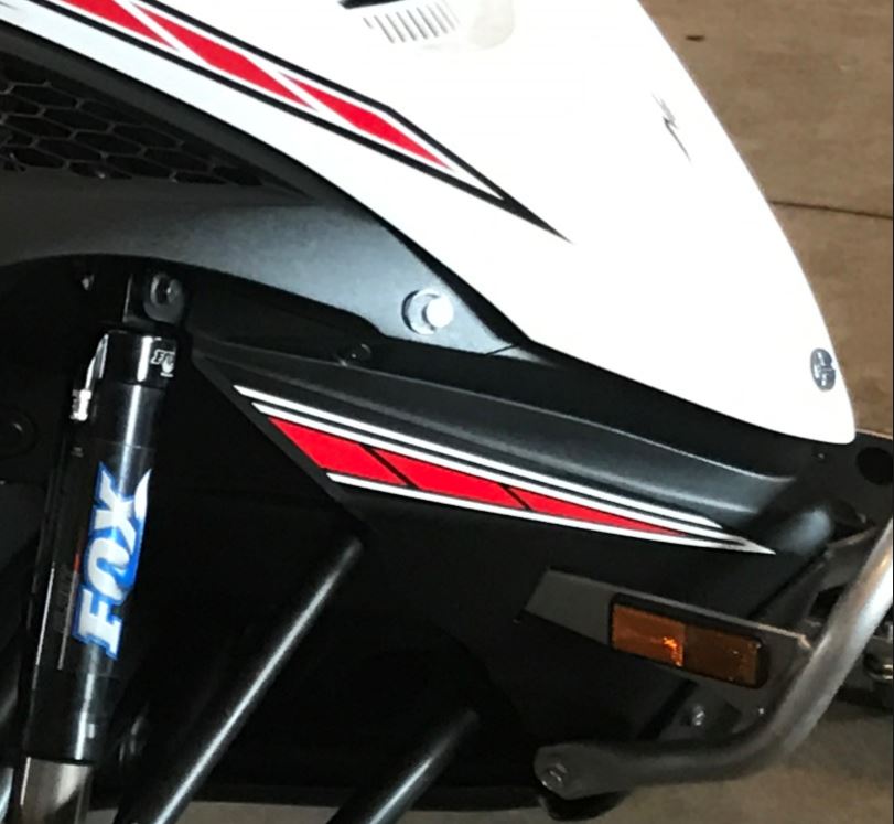

Although I sold my 08 Nytro to make room for the 18 Apex XTX, I still had the pictures I used to advertise it so hopefully these close-ups will help. And just for the record, I had to replace the one side but thought it was because it was a leftover (bought new in 2012) and was exposed to the elements during that time. After replacing it, I never had an issue with it or the other side coming off and I actually like the looks of those lower emblems and would be like you and want it original.

Awesome, thanks RobX-1! Your pictures will help a lot. Thank you. G.B.
