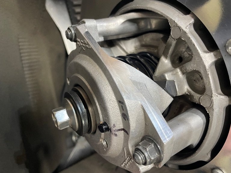

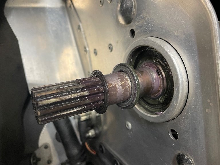

Mine has 2 spacer behind the clutch and just one thin one on the out by the bolt, I have around 1/4 inch of play total after it has been tightened.

You don't happen to have a picture of this do you?Mine has 2 spacer behind the clutch and just one thin one on the out by the bolt, I have around 1/4 inch of play total after it has been tightened.

I can get you a picture tomorrow afternoon.
Are you positive the big spacer that goes over the bolt is seated all the way in there?? They can catch, I've had it happen & when ya tighten the bolt it looks exactly like what you've got going on there.

I don't think it is catching I have play with spacer and the bolt could never get it to go down any further than that I believe I'm missing a spacer behind the clutch but also not sure if there is one behind itAre you positive the big spacer that goes over the bolt is seated all the way in there?? They can catch, I've had it happen & when ya tighten the bolt it looks exactly like what you've got going on there.
