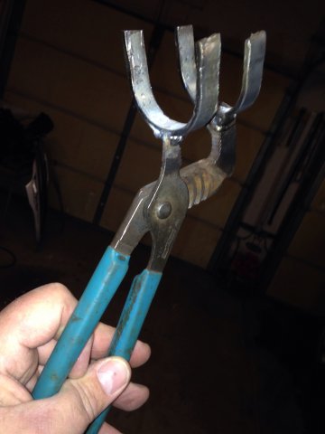

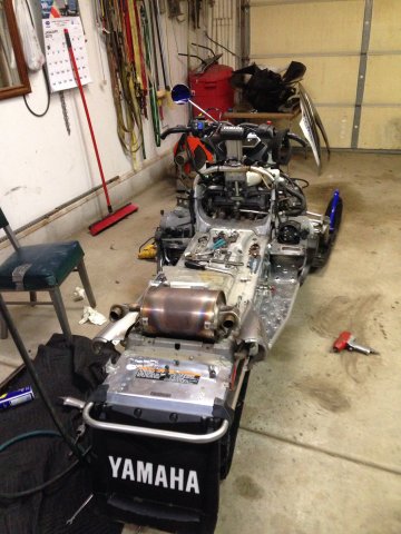

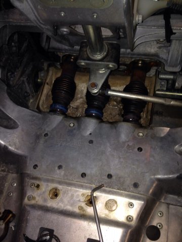

Had the rattle like I've seen talked about on TY. Took sled apart to get to doughnuts, the two front hanger bolts were torx and the torx stripped. Used my burp gun with sharp chissel on it and spun bolts loose. Will be replacing with stainless steel hex head bolts. Dealer wants $14. each for stock doughnuts. FYI for $4. each you can get
Felpro Exhaust Pipe Flange/ring for a 1954-1979 VW, part number 22571 that fits perfect. I know a lot of guys says to use copper ones, but those are pricey. I also made a tool that works great for compressing the accordian flange. See pics. Oh yea, groung a smidge off the clamps too. Thanks for all the info on this site. Will be greasing jackshaft and drive shaft bearings tomorrow with method I found out about on this site.
