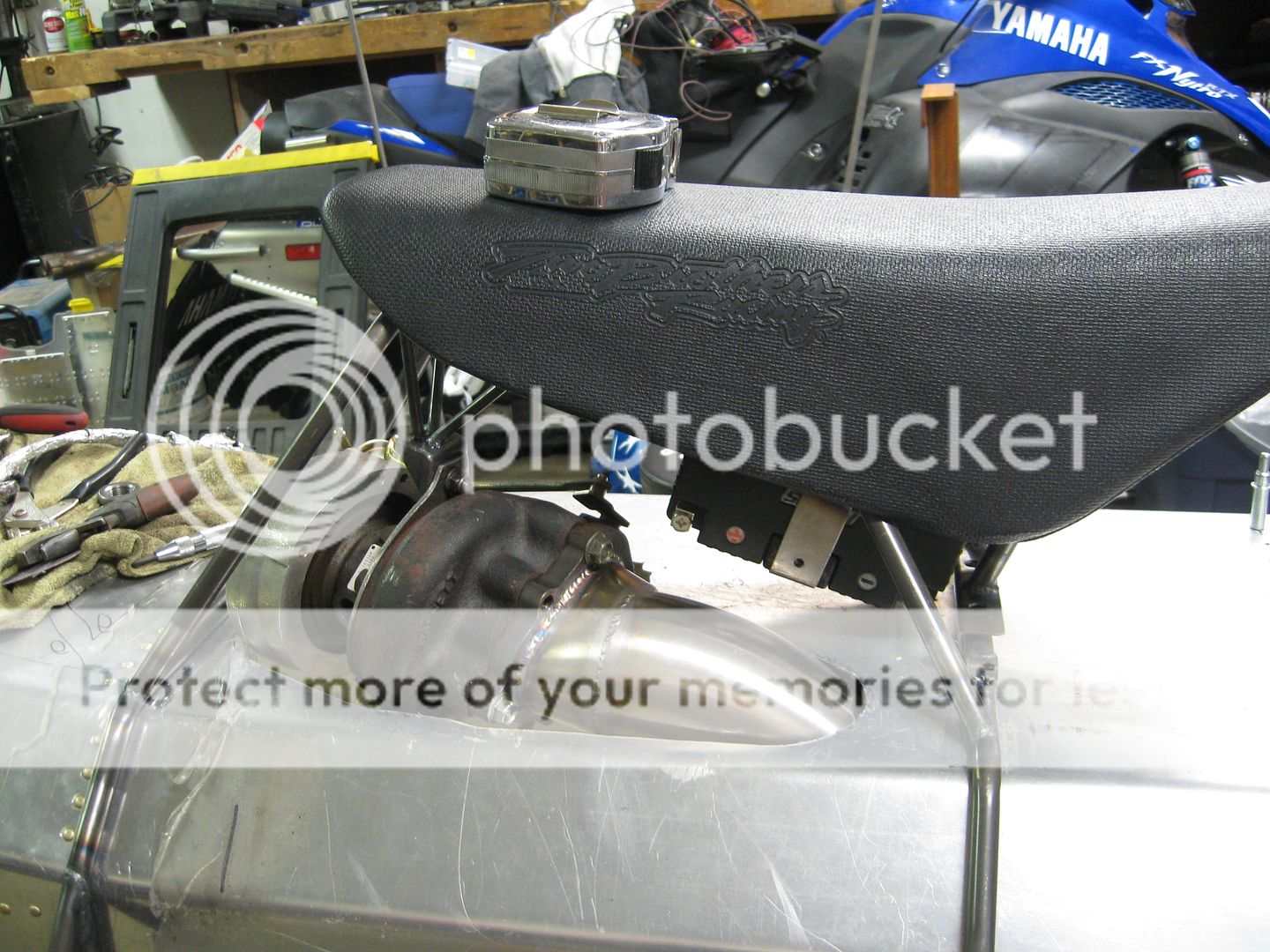

Awesome sled! I assume the hot side exhaust is just pointed at the track. Haven't seen any damage to the track from the heat? I assume it won't be a problem while moving but what about idle time during warmup?
Also if you don't mind what are the specs of the turbo? Trim? Hot side a/r?
Nikolai
Drew or Rick would have to chime in on the turbo specs, I'm not sure.

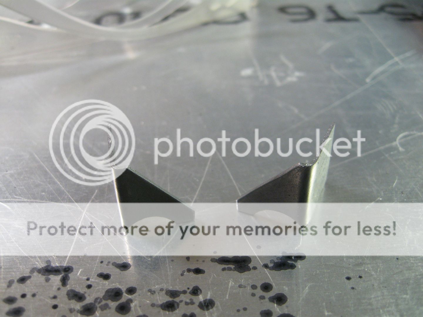

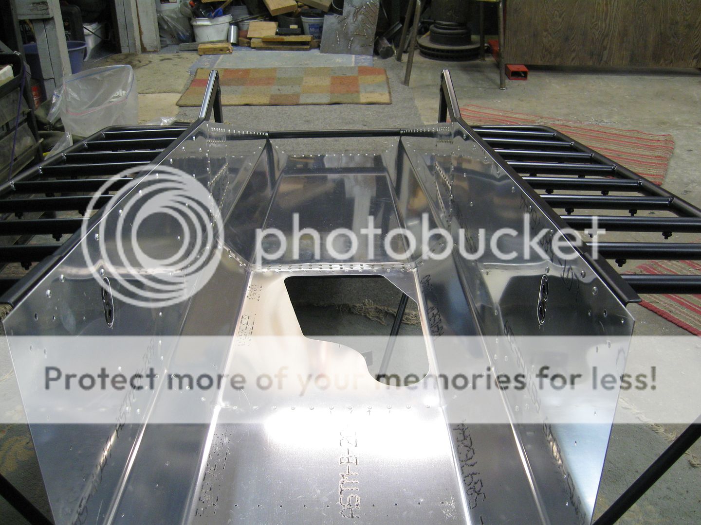

Tunnel skin all trimmed up and ready to rivet weighed 9 lbs 6 ounces.
Turbo cutout cleaned up.
Clecod
Riveted. I weighed the aftermath of the rivet parts and it was about 3.5 ounces, so total weigh gain of 150 #4 cherry max rivets is roughly 2.5 ounces.
Done. Complete tunnel weight is 27 lbs 9 ounces.
