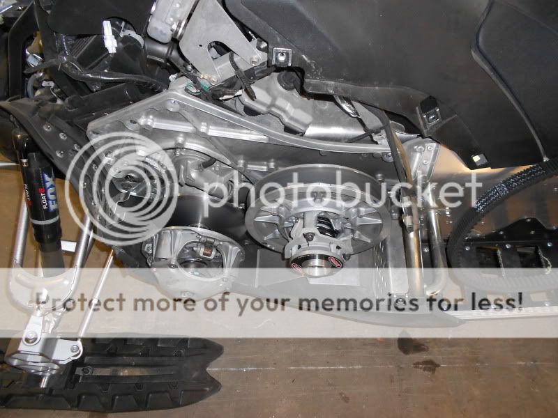

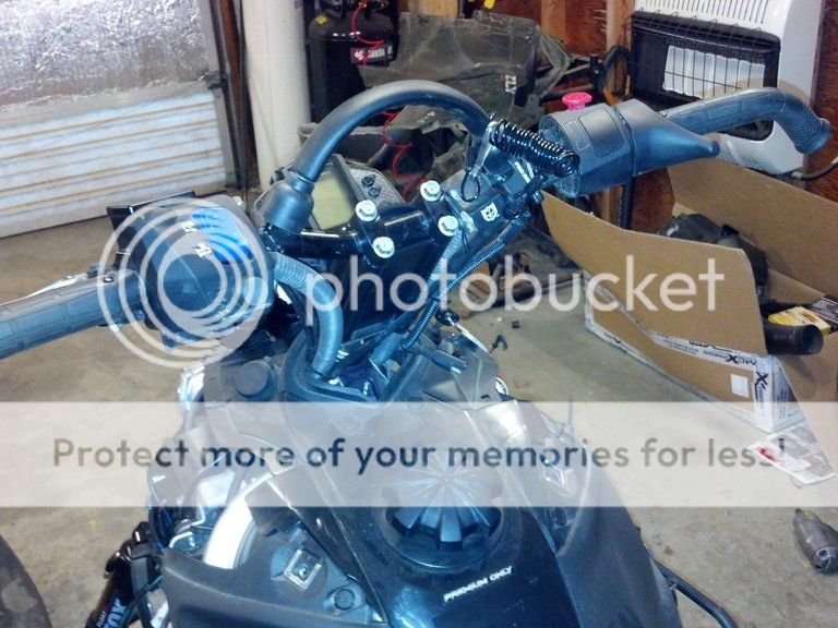

last weekend i just went down and picked up my sled from Ulmer Racing. Allen installed the MCX 180 kit. Of course as soon as I got it home i had to dig in and see how it looked
Here is a shot of the turbo and one of how he installed the gauges with the roest IP vent kit. The gauges are easy to read standing up, and I love the roest relocator, so i think this will be a good setup all the way around.

looks like a nice clean install... great job on the guages.

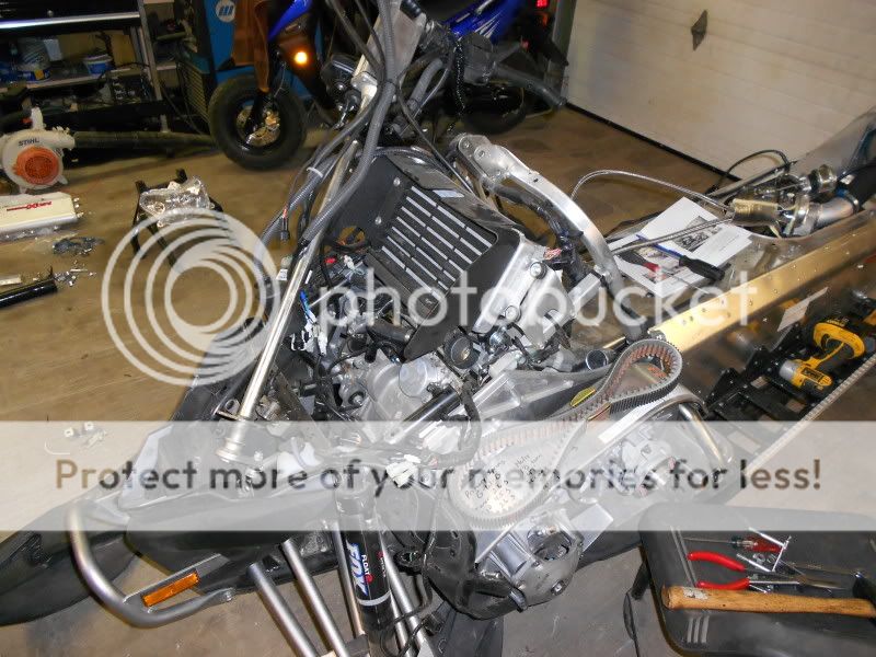

Some more pictures of the turbo build up.

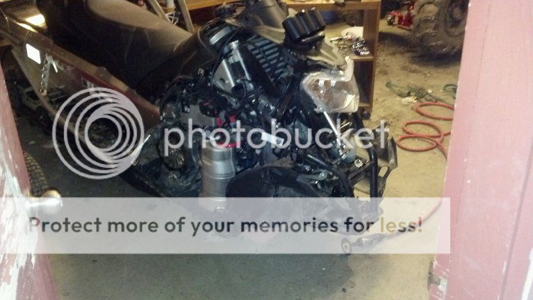

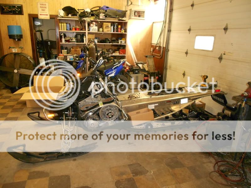

doing some more work to the sled. i have it ready for when i get my skinz front end and shocks back from oft. i also have some oilite bushings coming from ulmer. i put the skinz tunnel braces on the other day. i may do the airframes one day, maybe not. im a big guy and these braces made a HUGE difference in flex for me. they are pretty stiff now. i made my own snorkel for my turbo out of a 90 degree turbo tube elbow and aluminum joint connector i purchased off ebay. looks like things are coming together. next purchases i think will be an oft big nutz 3 wheel kit. id like to put a kmod skid in, but i dont think it will be in the budget this year. you can also see the yamaha rear rack in the last picture.

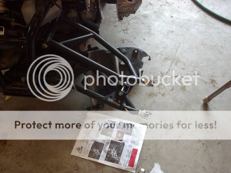

Here are a few updated pictures. a arms are off and i should have my skinz front end in a few days. also pulled the track out, i just ordered a 153 challenger extreme 2.5 from tracks usa too so the chaincase is apart as well. i also have purchased a powder coat kit from eastwood and i am going to be making a powder coat oven from an old fridge. i am going to start by coating my spindles, riser block, and front and rear bumpers. if all goes well ill probably start powder coating every small piece i can get off the sled! rails and other rear suspension components would probably be next though. i also purchased a snowjack that is what is holding up the rear of the sled atm. it will be nice when i ride solo around the plains.

finally got my skinz kit in. i also got my new 2.5 CE track too! Here are a few install pics. i first installed my ulmer oilite bushings. to remove the stock ones i just used a punch and hammered them out. to install them i just got a bolt with some washers and pulled them through. i also purchased a powder coating gun! i am using an old oven in my basement that i have never used for curing. i did my spindles today in satin black and they turned out pretty dang good. i am going to do my front and rear bumpers as well as a few other parts. I did miss a few corners in the spindles, i think i am just going to touch up with some spray paint. i was pretty happy for my first go at it. i was suprised how cheap it was to get into it as well. the gun was $100, $10 for some powder and thats about it. prep work was the hardest. i bought some powder stripper and it didnt work very good so i did a fair amount of sanding (dont have a sand blaster).
