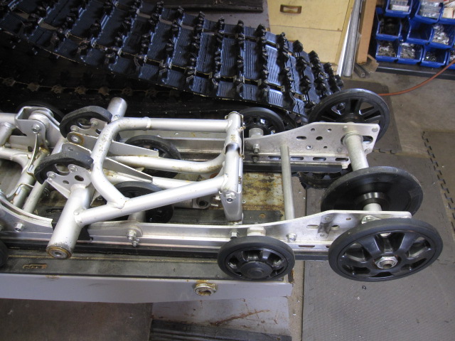

As you can see I ripped the skid down and started to add the billet machined Tracks USA rail extensions to the 128" rails. They sure make some nice extensions. The only holes that were not provided are the track tension adjuster mount holes. I located them off the rear wheel guide mount holes 2 5/8" (See Pic)

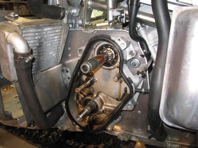

Pulled the gear case apart, changed bearings and seals and reinstalled the new track.
