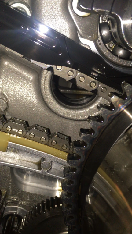

You can tell if you have the new style motor by the rubber half moons Yes, but Yamaha flat out missed heat treating a number of connecting rods in the new style motor and they are normally gernading within 5-10 miles under boost. Yamaha is only fixing the rods of 2016 owners who at pickup installed a MPI turbo at the dealer. Pretty rotten deal for the rest of us 2016 owners.
