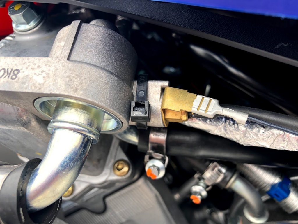

early this year someone posted a picture of the new rollover valve on the new 2020. The valve looked to be heated. You guys with the 2020’s can you verify this new valve? Maybe take a few photos. Does anybody know if you can retro fit the new valve for the 17-19.

Tring to find that picture of it ....

I took these at the show last spring....Have not seen a recent production model yet.

The rollover valve has changed and the location of it has changed. I just snapped a couple pics but I can't post them because they are too big.

Yes the production 2020s have changed from pre production

What is the purpose of the rollover valve?Hard to see the rollover valve but its up in the center of the sled under the steering column kinda...
