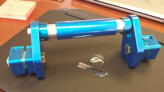

Hey guys I purchased a 3 wheel offset axle from tricked toys and I'm running 3 9.5 inch proline wheels the issue I. Having is trying g to get the outter wheels aligned on tracked I had it perfect on the stand then took it out and bang right out to lunch again the problem is with the outter wheels on u can get to the nut that snugs axle together in rails to tighten and loosen track I'm not sire what I'm doin wrong to get them perfect on the track

Here's a pic from their site. Looks like you just need to get a thin wrench on the back side of the block to tighten the outer axels down. Kinda surprised they didn't seat those bolt heads to make it easier. You always want to tighten the side that has the bigger reveal from the wheel to the edge of the track. By this I mean, loosen both axels and tighten the adjuster on the side with the bigger reveal.

Been a common problem with Tricked Toys offset axles since day 1. I have been using their stuff since 2005 era. Same issue with all of them - how to loosen/align/tighten track with outside wheels on.
Looks like quality stuff. Not a big fan of the aluminum wheels, but they look killer. Those bolts should be captiveBeen a common problem with Tricked Toys offset axles since day 1. I have been using their stuff since 2005 era. Same issue with all of them - how to loosen/align/tighten track with outside wheels on.

Outside wheels block access to axle bolts.Looks like quality stuff. Not a big fan of the aluminum wheels, but they look killer. Those bolts should be captive
Guess it would help to see a pic with the wheels on.Outside wheels block access to axle bolts.
REDLINE 1
Can’t reach around the front and get a wrench in? As suggested they should be captive. Sounds like a question for TT.Outside wheels block access to axle bolts.
Had there wheels on my 05 Mach Z they sure looked cool had a plastic insert on the wheel to keep the stud heads from chewing the aluminum up. Seemed like more of a bling thing than performance improver to me

Not on the kits I bought from them over years. Axle bolt is in a cut out area so from front you can't even see it. Access is through track windows with a custom bent 9/16" wrench. Ugly. Yes, bling thing.Can’t reach around the front and get a wrench in? As suggested they should be captive. Sounds like a question for TT.

Yes and as an added feature the new billet adjusters sit further out making it a whole lot easier to make adjustments as there is no need to get a wrench inside the rail window. Socket and long extension fits on the bolts without gouging the rails

if I’m understanding your question correctly. Can you not adjust track with outside wheels on then take them off and tighten axel then put wheels back on?Hey guys I purchased a 3 wheel offset axle from tricked toys and I'm running 3 9.5 inch proline wheels the issue I. Having is trying g to get the outter wheels aligned on tracked I had it perfect on the stand then took it out and bang right out to lunch again the problem is with the outter wheels on u can get to the nut that snugs axle together in rails to tighten and loosen track I'm not sire what I'm doin wrong to get them perfect on the track
