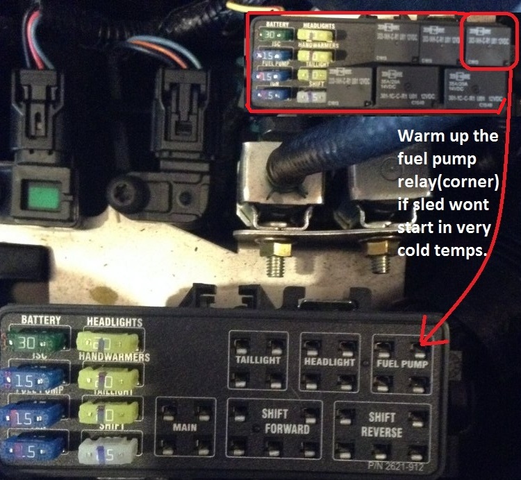

Just remember it's not always just the fuel pump relay, it could be any of them...Cannondale...
I made up a nice simple self explanatory image so guys can just keep this image on their phones to remember when their sled wont start.
Can you STICKY this image for us?

This is true but I'm thinking the sled will start and run if the fuel pump and the main relays are not froze. The others will warm up after start up.Just remember it's not always just the fuel pump relay, it could be any of them...

This is great man! Excellent workCannondale...

Big thanks to DMCTurbo for pics!
My main riding area is up north and temp below -30C is common at night and sled has to stay outside overnight.
Just last weekend we had -26C and I got a sd-08 code all 3 mornings... nothing serious because the code went off after warming up the sled but still annoying not having reverse. Dealer is taking care of it...

Hmm battery operated mini blow dryer out on the trail will look good. Maybe blue with tuning fork decals.
Will do. Will put it in first post of the thread. Thank you! I need to add that my oldest girl who lacks mechanical aptitude has repeatedly out ridden many men twice her age. I think she may come on here once in awhile and I don’t hold her lack of knowledge against her at all.Cannondale...

-30c sled started no problem. Warmed it up from -24c to 50c. Shut it down while my doo buddies boosted theirs. Went to start it again and I had no power to my dash due to condensation freezing in my main relay. Long story short I had to remove the relays and warm them up. They are located in the fuse compartment. Just an FYI
Added your pic to first post. Thank You!Cannondale...
