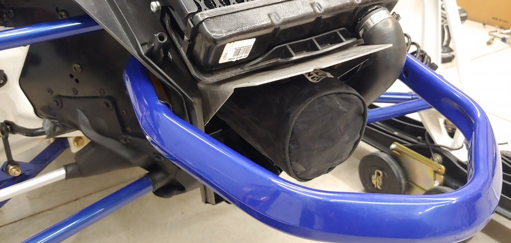

Very creative, has it ever been caked with powder? The front end of the SWs get a lot of ice built up on the front end of the inter-cooler.I have the MPI turbo kit on my 15 LTX and moved the intake to the nose of the sled under the radiator. I don't like thetthe looks of the out of the hood intakes. Moving it not only got it away from the belt dust, it also dropped my intake temps 50-degrees (in similar ambient temps).
View attachment 155568 View attachment 155569
No, I am a trail rider and it never gets iced up in the front like Sidewinders do.
