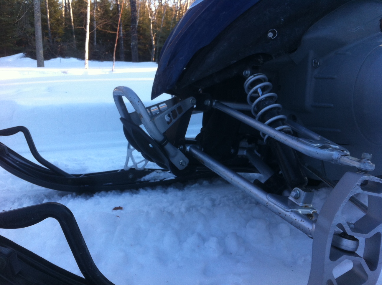

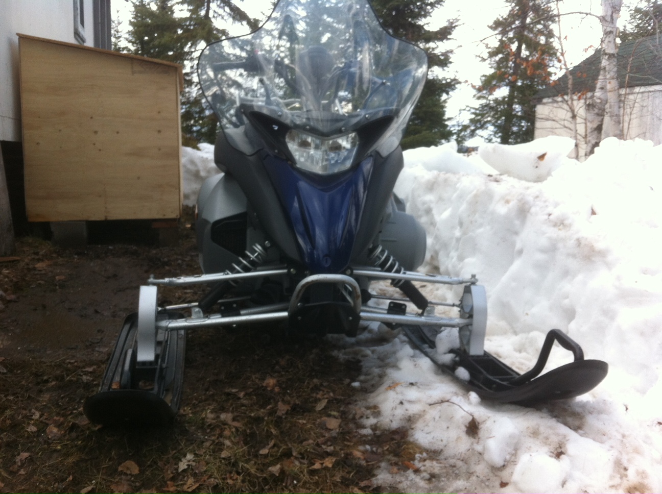

So I decided to make my money go a little further and I went with the 9" ski skins. I also ordered the ultra plate. Parts should be in this week, hopefully testing her out by Friday. Thanks again, i'll let you know how they work.
Hey asmerch204, would you please post some pics of the Ultra Plate when installed, I have been wondering what they look like on a VL/MP. Was thinking of one for my 2013 MP
Sorry daboog, I didn't install it until about a month ago and by then I forgot to post photos. It fit good no issues and offers a lot more protection than the thin piece of plastic it covers. I don't think it will offer much float but with the 9" ski skins I don't really need much in that department anymore.

Nice. Is that the one from Yamaha? How much did you get it for?
Too bad there isn't another manufacturer or if we could get it directly from them but either way, looks like it was worth it.
