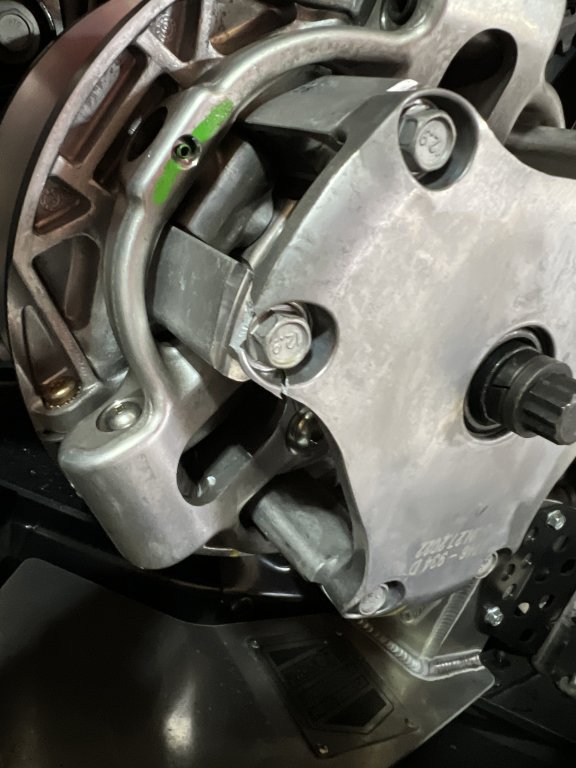

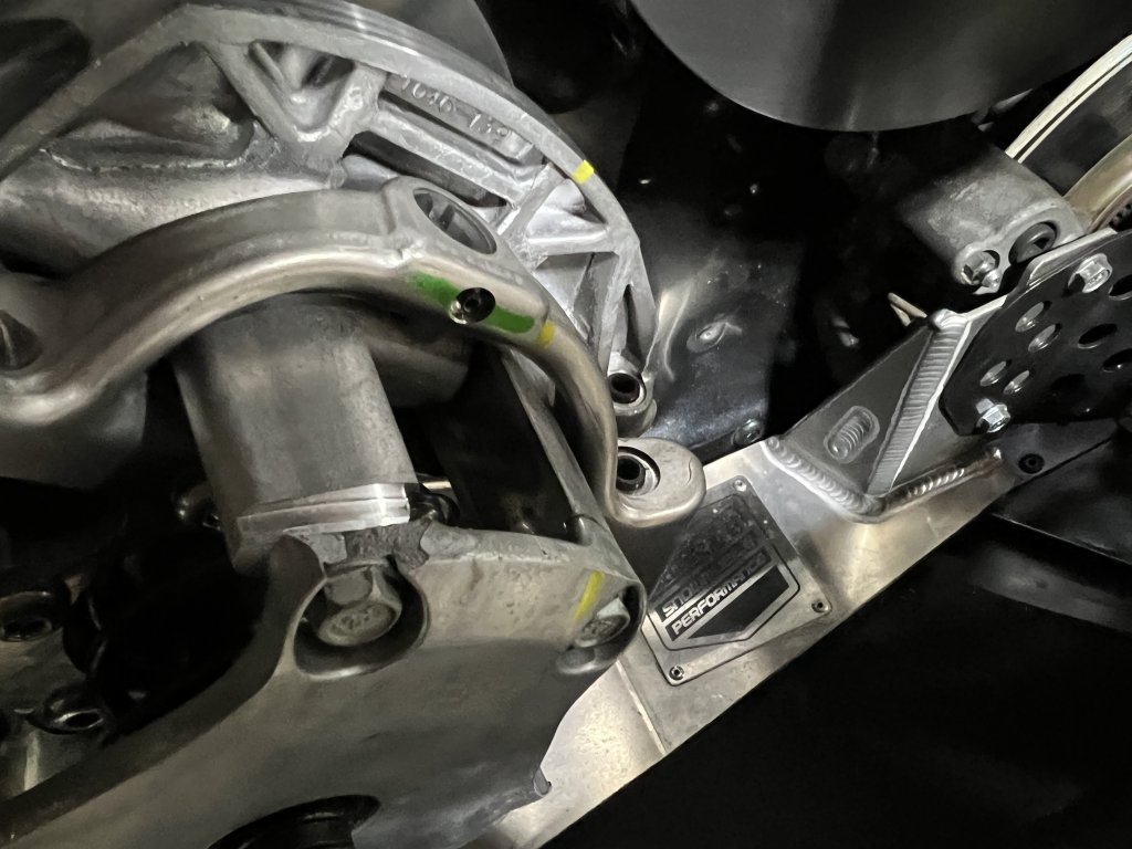

no1b4me
- Dec 31, 2016
- 207
- 235
- 713
- 2019 ZR9000 Ltd iACT
Curiosity is asking what fly weights(part#) were used in this clutch ? And is it tuned?Have another broken cover on another 23 Thundercat. From what I can tell, if you stay in the throttle when the sled stops upshifting (trying to squeeze mph in less than ideal conditions), it puts too much pressure on the primary and flexes the towers.
View attachment 171454View attachment 171455
WinderFab
- Mar 1, 2009
- 1,880
- 1,129
- Woodbridge, ON
- 2020 Sidewinder Ltx GT
Stick to the stock primary haha..Curiosity is asking what fly weights(part#) were used in this clutch ? And is it tuned?

It’s tuned with Dalton weights in itCuriosity is asking what fly weights(part#) were used in this clutch ? And is it tuned?

We are having good luck with 60ys stm in adapts
Have to have side bushings

From the failures I have seen posted on the net, fly weights were retro fitted to sit in the saddle with spacers on the movable sheave... I have also seen the spacers used worn and burred over.... The other thing they are also to short and bind when the weight tip goes over center on the roller and then it's a chain reaction of energy not retracting evenly causing excess torque onto the towers and causing them to deflect and fracture the cover... This application I would only use specific made fly weights for the ADAPT... This way the OEM thrust washer is in place to ensure free movement.... My opinion...
