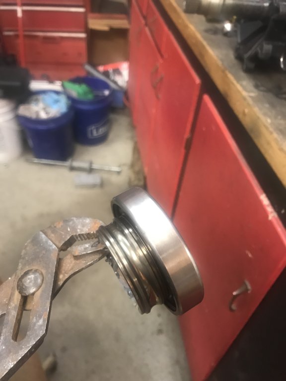

while working on a fix or the problem with the brake caliper side bearing and driveshaft we have determined the rotor is being ground down by the bearing race. Measured bearing race against a new and bearings are having little wear while the rotor is loosing over 2 mm in width. The rotor is now also 3 mm larger than the shaft. Might want to pin the rotor. I agree the race is spinning but the rotor is missing metal and acting as sand paper on the shaft as it spins and rattles.

I noticed my brake rotor was also very worn there on the bearing side. Not quite to the point of replacement yet, but wouldn't want it worn down anymore.
Another reason I put an O-ring on the shaft behind the bearing and inboard circlip and set-screwed and loctited the bearing. I don't want that friggen bearing spinning again!

This bearing that spins causes premature brake rotor failure and driveshaft wear. I will pin mine next year.
