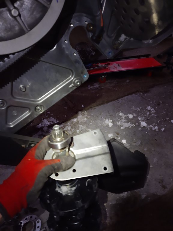

Almost got the track off but caught on the nubs inside the tunnel on the chain case side. Trying to upload a picture, but size is limited. I pulled the driveshaft out as far as I could till the drivers get in the way. What am I missing? Can't twist it out? Trying to put a 151 on it.

Pull the drive axle out completely and the track will fall out.

Take off the metal plate that holds the bearing on the left side.

https://www.cyclepartsnation.com/oemparts/a/yam/5003c4ebf8700212fc842641/track-drive-1Take off the metal plate that holds the bearing on the left side.
Number seven in this picture.

Ok, awesome, I took off the other plate, but not that one. I'll take that off when I get home tonight. Any thoughts on that tablesaw question from anyone? Fine teeth or coarse?

Also remove the toothed speed sensor cog on the end of the shaft for extra clearance. Might also have to remove the set screws from that bearing on the shaft so it will slide off.

I've changed tracks on pretty much every brand of sled there is, and the phazer and nytro drop out plate makes their driveshafts the easiest to remove by far.
Beauty design. Don't even have to remove bearing, speedo sensor pickup if you don't want to.

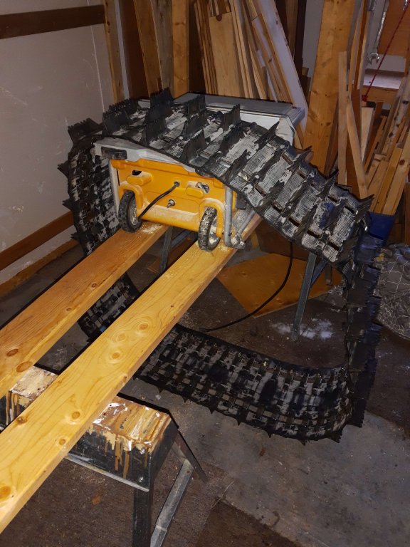

Ok awesome, that plate made all the difference, thanks! I figured after struggling for 20 minutes trying to get it around those nubs I was on the wrong track. Also now I understand the confusion for cutting the track. See picture, different method. Will be cutting tonight so see how it goes.

The table saw with the track looped around the saw worked, but was pretty rough compared to the video of flipping the track. Might be worth doing that. Ended up trying a coarse and fine toothed blade. Didn't make a difference. Was aiming for 14 1/2 wide and got 14 after. I think the video I saw used a wood spacer so the rubber wouldn't fall down into the saw blade. Seemed to work better with the track between fence and blade vs. the cut-off part between the fence and blade. Bit rough to say the least, fence got pushed too on my saw which didn't help. really kicks through the fiberglass and gets hung up in the lugs.
