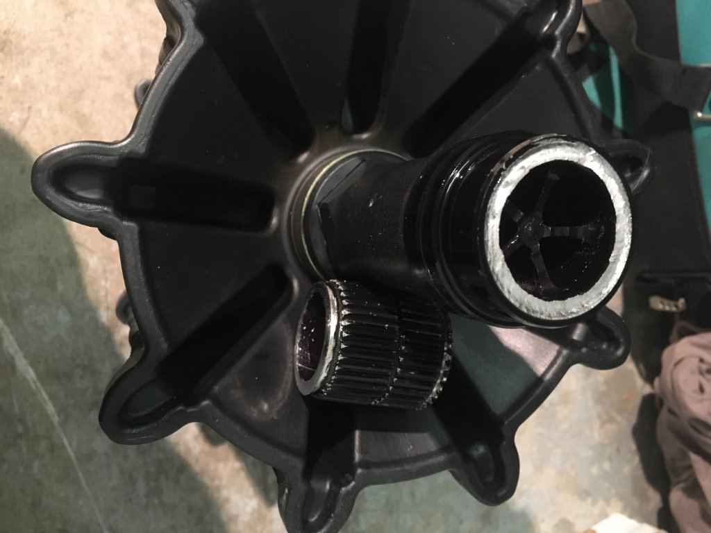

Black Diamond Xtreme aluminum drive shaft after 60km.

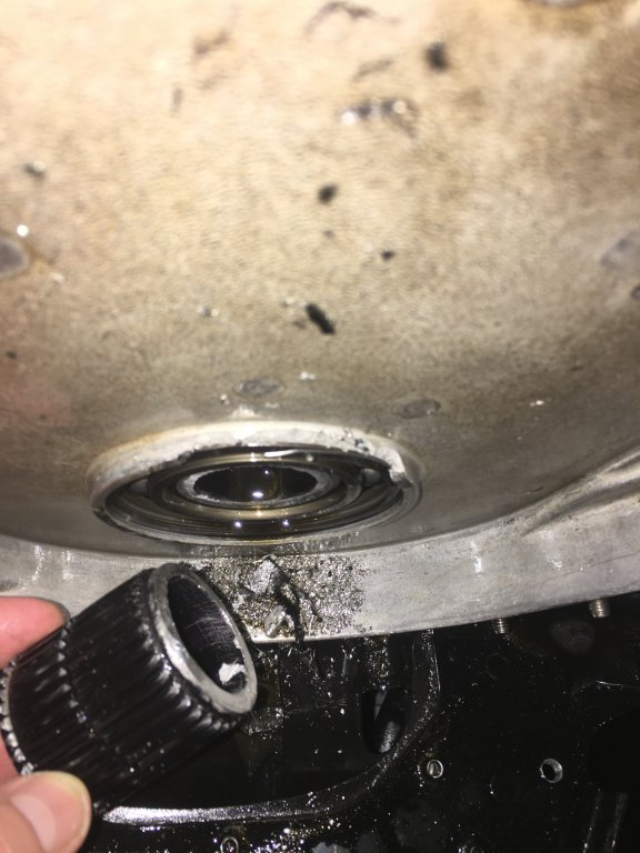

Around 1800-2000$ canadian worth of parts has been damaged +lots of time
The answer from BDX 3 days after my e-mail says. "The shaft have a warranty "and they do have stronger one......lol. Well...... They asked me some pics of the shaft,which i provide +video,couples minutes after their mail. No answer 24 hours later
This shaft maybe strong enough to hold tomato plants!?!?!?
I am waiting for dealer parts and some being repair, drive shaft bearing assy at chrome(The shop had 16 to dobased in montreal)

10weeks after,it was under the trees whit lightweight rotor,i though it was a TEKVEST !
Bdx say it's 20%stronger than AC shaft.

Both casing back and cover are being repair at one of my best friends shop. I am lucky one of the 2 is BO.Both drive gear are ok whit little bit of love. All clips, washer and tensioner are fine.It looks like it did......
Need both chain +reverse gears and "reverse U"
Bearings
Speedsensor(BO)
Shaft is back from rebuilt, it is BO also here ....
