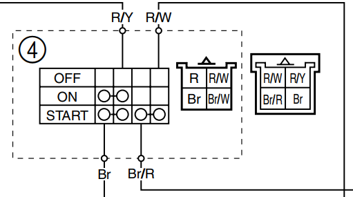

'07 VK Pro that had been starting just fine until this past weekend, when I started it up per normal, but it was struggling a bit more than normal while things warmed up and would stall when I turned down the choke. After restarting a couple of times, it has now quit completely - I've got absolutely nothing happening when turning the key - no lights, no clicks or buzzes, nothing.
Checked fuses (including main starter fuse, under the airbox). Battery is good. Given the process leading to apparent death, cycling the key, I'm suspecting the ignition switch itself - how can I diagnose (bypass?) the ignition switch? I've got it pulled out... 4-pin connector as such:
And yes, kill switch is pulled out.

Jump the starter relay maybe , if it cranks, see if the switch has power. Grounds on upper frame and in general ok ? Salt ?Hi folks;
