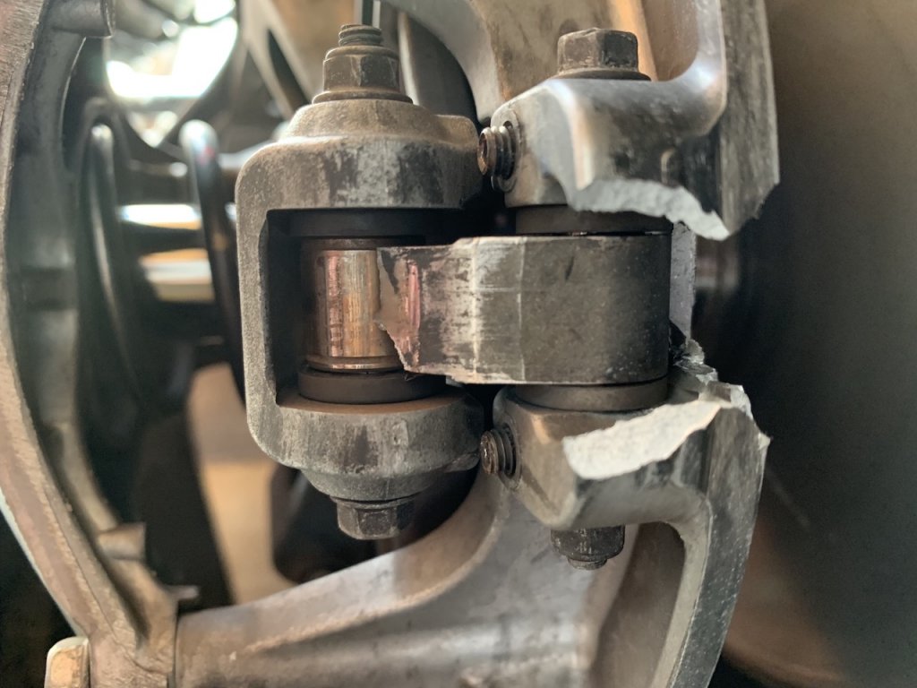

Have a snickersIt wouldn't have even mattered in this case. As per the original comment, 'the rollers had a bit of play'.
A bit? Look at the pics. They're f***ed. And they still drove it.
I also question if they were even oem rollers and bushings.
I'm getting more than a little fed up when people fill their clutch full of non-oem parts, explode them, come here to vent and claim Yamaha builds a garbage clutch.

That pic of the roller has 1500 miles on it still in spec at 9.14[ATT

Do you think the rollers caused this , looks like the weight snapped in halfOut on the lake this weekend with a buddy of mine. First pull rolling on from about 30 mph, and this happened to him at about 100.
Things I know:
It's been posted before, and I'll say it again -- these primary clutches NEED to be inspected frequently, and I would not be doing any hard pulls unless you know everything is 100% in your driveline.
- STM weights
- Dalton B/G primary, Dalton B/O secondary
- 22/41, 8JP
- 1.25 Ice Ripper track
- Rollers had a bit of play in them and were going to be swapped out
I have no confidence in the stock primary, and won't be running it next season.View attachment 147949View attachment 147949 View attachment 147950
View attachment 147949 View attachment 147950 View attachment 147951

seems like the after market weights are failing like the weight brokeI'm sure you know this but ideally, the roller bushing fits the pin it rotates on with no lateral play. In other words, it should fit virtually line-to-line meaning no play. Same goes for bushings in weights.

The weight did break in half, know of a few from this manufacturer.

The weight did break in half but after it went past the roller. There’s no way that little stub left on the pivot caused sheave to break inward like in the pic.The weight did break in half, know of a few from this manufacturer.
I’m sure when it went past the roller and broke the sheave it got behind the belt and broke off the weight. Not the weights fault, worn roller.
