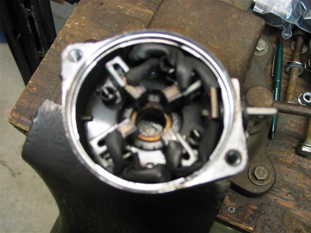

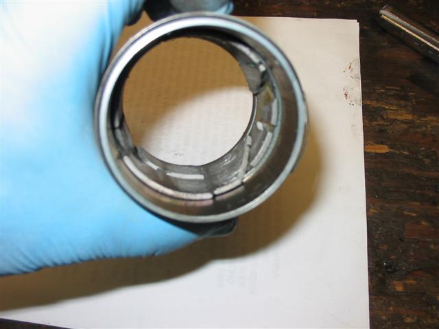

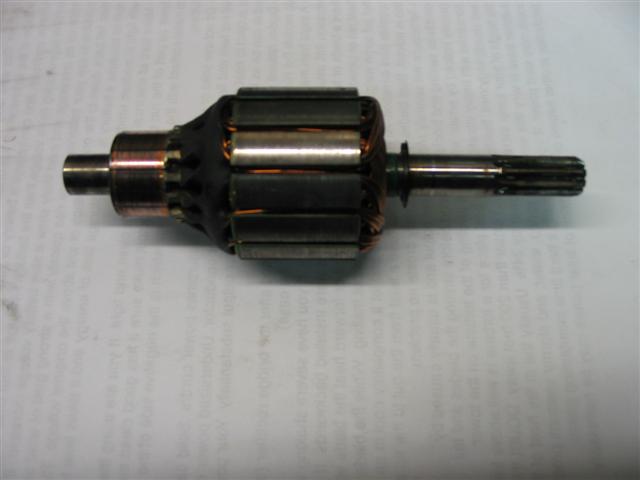

Well it's the new year and the starter on my 07 MTX is crapping out after 5 years and 7,500 miles. I removed the starter last year and loctited the bolts and checked index and the internals were in good shape. Tore starter out and the outer shell magnetic lining is coming apart causing slow turn over about 210 rpms. I did notice it starting to roll over slower this year but it went from 280 rpm right too 210 rpm when it crapped out.

Update on starter issue, picked up used starter from 07 with 800 miles with blown motor. Of course bolts were not real tight so loctite was the cure there. Install from modification took only 10 minutes to connect cables and bolted in with no removal of front frame assembly. I will create a quick how to on new thread with video.
