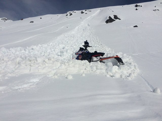

1st ride on my 2015 turbo viper ..... I climb a chute in chute I notice oil light is on while wheelying up the chute it goes into limp mode loosing all power then shuts off slides backwards and digs in! I think oh cool we are stopping wrong the track digs in and starts an avalanche that either would have been behind me as I went over the top or never happened! Anyway I was pretty irritated and have been looking for a fix ..... I think I can modify where the oil tank is and reroute exhaust back to where oil tank is now and fix the problem but if anyone knows of an aftermarket company making a fix for the losing oil prime I would be glad to hear about it? Thanks
