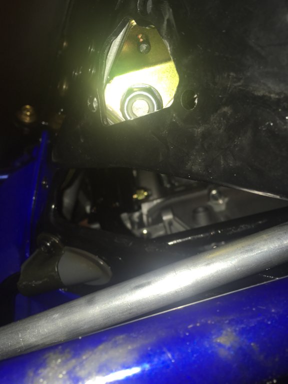

i have a 16 and the end of last season i went from 1" of play to about 2.5" side to side play on one ride. My bolt was very loose and didnt catch it in time and it egged out my brackets. I ordered the country cat update kit and it does not fit the 7000/viper. The brackets are alittle different and
http://countrycat.com/ccstore/index...-bracket-upgrade-kit-2012-2014-zr-f-xf-m.htmL
The kit moves the bracket around and the steering post bolt is not inline with the access underneath to tighten the steering post bolt.
So i went to yamahas site and the parts for a 16 were around $80 and i looked at cat and they were about $40 shipped. I just recieved them today and now i looked and it looks like the 2017 sr vipers have a new design with a reinforcement bracket rivited on.

now i think the 2017 models have an updated kit as these are the part #'s listed. These also come with the bracket update kit on the top of the link. To me i couldnt get a socket through the access hole to tighten the post with this bracket kit. Im really not sure and I am just going to put the same part #'s that came off back on.
