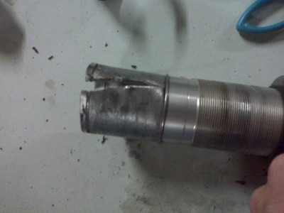

this is the front track shock out of my 08 fx nytro, i had it revalved when i first got the sled, and i was very happy with the valving i thought it work awesome, i put 3800 miles on it like that.
Last winter i put a 144 extension in it, i liked that too thought it rode much better.and i put 600 miles on it, in that form
the other day i took the skid out to have the shocks rebuilt and change some wheels and found the shock like this, there is no oil in my trailer or on the floor of the garage where i store it, so i must have been ridding it like that at least one ride (last time out was colebrook nh 125 miles pretty rough), i didnt think it was ridding bad or anything but i had to have been ridding it with a wasted shock
anyone got an opinion as to what happened? i am guessing water got in there and it froze and busted the shock, and i did not have the shock serviced every season like i was supposed to
i bought a fox zero pro to replace it for 269 from carver performance i think thats pretty reasonable

Common problem, it has happened to a bunch of guys on here.

looks like my rear shock from my xtx. Good that I had warranty

But mine were just done again and they told me they are now using an updated seal that is better. I'm not an expert on this stuff but I'll bet that most blown out bodies are from leaky seals taking in water then freezing.
I wonder if Yamaha in the future will turn the shocks around rod down??

I thought i saw somewhere bigger fluid transfer hoses for the piggyback that helps this condition too..... Cant remember where tho
