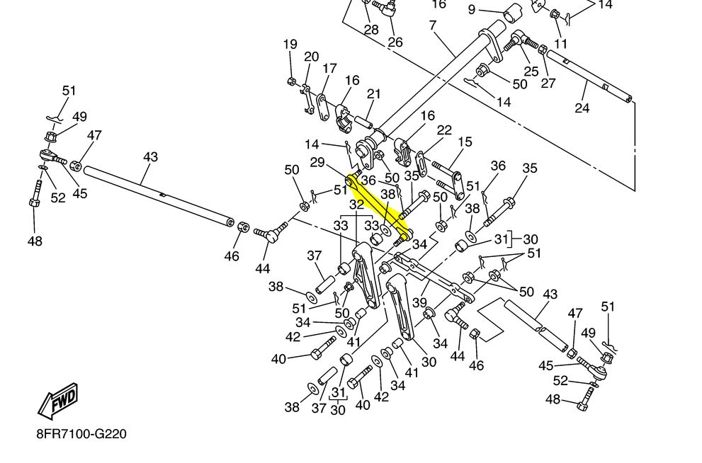

I have been working on this today. I have another question. How did you get the bolt off of the steering rod that is connected to the steering shaft? I can go the kotter pin and the nut off but now cannot get the bolt out of the steering column. Do I need to get a puller? I applied some hammer force and it did not move. Help?

If you're referring to this part, I had to replace mine and found heat helped get the bolt out. It's almost like it's pressed on. I even tried a C-clamp but didn't have much luck. When re-installing and since I completely removed the rod, I stuck it in a freezer for a couple of hours and then used heat gun to heat up area around hole and it slid right into place.

Just hit on the side of it with a hammer the vibration will loosen it up.I have been working on this today. I have another question. How did you get the bolt off of the steering rod that is connected to the steering shaft? I can go the kotter pin and the nut off but now cannot get the bolt out of the steering column. Do I need to get a puller? I applied some hammer force and it did not move. Help?
