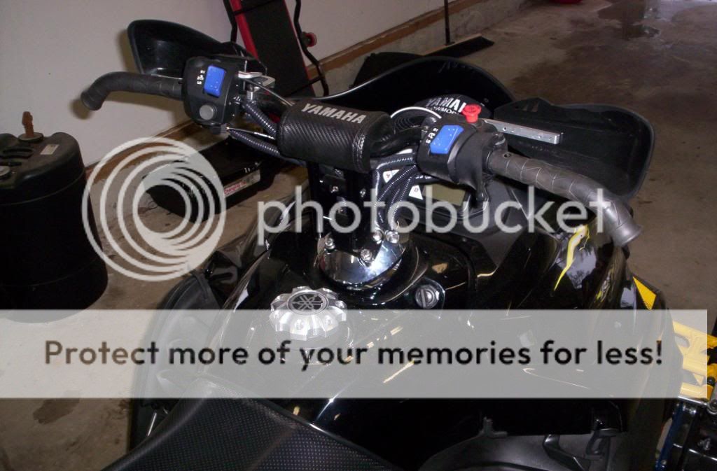

I have 07 Apex bars on my RX Warrior the plugs on the grip[s are not the same but some people have wired them to make them work but im getting a yamaheater to make them plug and play. Which will also make the apex bars warmer which most people complain about.

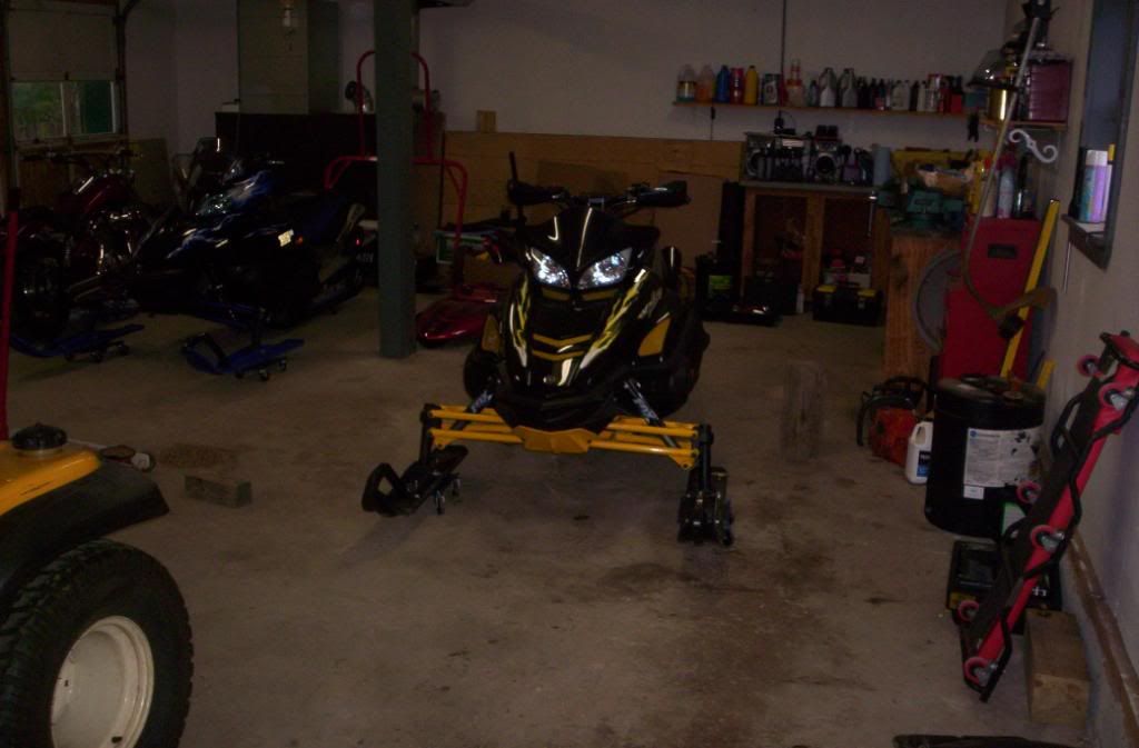

When my sled was red I had a 4" block riser with RX bars
Now I have a LES Riser 2.5" pivot with 5" block with 07 Apex bars

The Apex bars have a different system than the RX series. The Apex needs power and negative to both bars and the RX has a closed loop system where the power goes in to one bar and the nbegative hooks to the other bar. If you go with the Apex bars It is worth every penny to Add the Yamaheater because there is not enough power from the stator to run those bars unless the sled is running higher RPM's.

The 07 Apex bars must be connected in parallell, like said + and - have to go from the harness to both warmers. From + in the harness two wires goes to + on each of the warmers, the same goes for the - on the harness, two wires goes to each of the warmers, thus they are connected in parallell.
