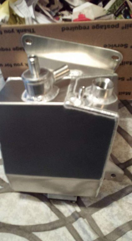

CFM Performance ATV sells an amazing aftermarket tank for $200.
OEM is $260 to $300.
You can buy them used for $50ish, but i wouldn't risk it...

stevieu1
Aftermarket...3000 miles and hasn't leaked.
biffdotorg
- Dec 2, 2008
- 2,240
- 1,156
- Pelican Rapids, MN
- www.biff.org
- Apex XTX and Viper LTX SE
- www.biff.org
That tank is beautiful. My 2012 is starting to leak. I have yet to pull the tank to see where it is coming from, but I cannot see any visible cracks. Just a thin line of oil around the seam. And the dipstick is not showing low. But there is definitely oil in the belly pan below the tank.

Like I've posted, I have 3 PC7 repaired tanks out there in friend's sleds and one was attempted to be welded and wound up with holes....the seam seeps. The trick is to smooth and feather edge the pc7 with lacquer thinner before it hardens. Work's every time. I did buy that same aftermarket tank but the supplied gasket (no o ring) leaked...lmao!!!! Finally I took a 45 degree carbide chamfer tool and made an o ring seal. It's OK now, but my fixed tanks are out there not leaking....for years. I ask the guys every time I see them. No leaks. I like PC7 better than jbweld.That tank is beautiful. My 2012 is starting to leak. I have yet to pull the tank to see where it is coming from, but I cannot see any visible cracks. Just a thin line of oil around the seam. And the dipstick is not showing low. But there is definitely oil in the belly pan below the tank.

This is my first attempt years ago, and the tank they burned holes in trying to weld. It is the spare when one leaks, as it takes a day or so for the pc7 to harden. My newer fixed ones are much nicer looking, but this one hasn't leaked either.
