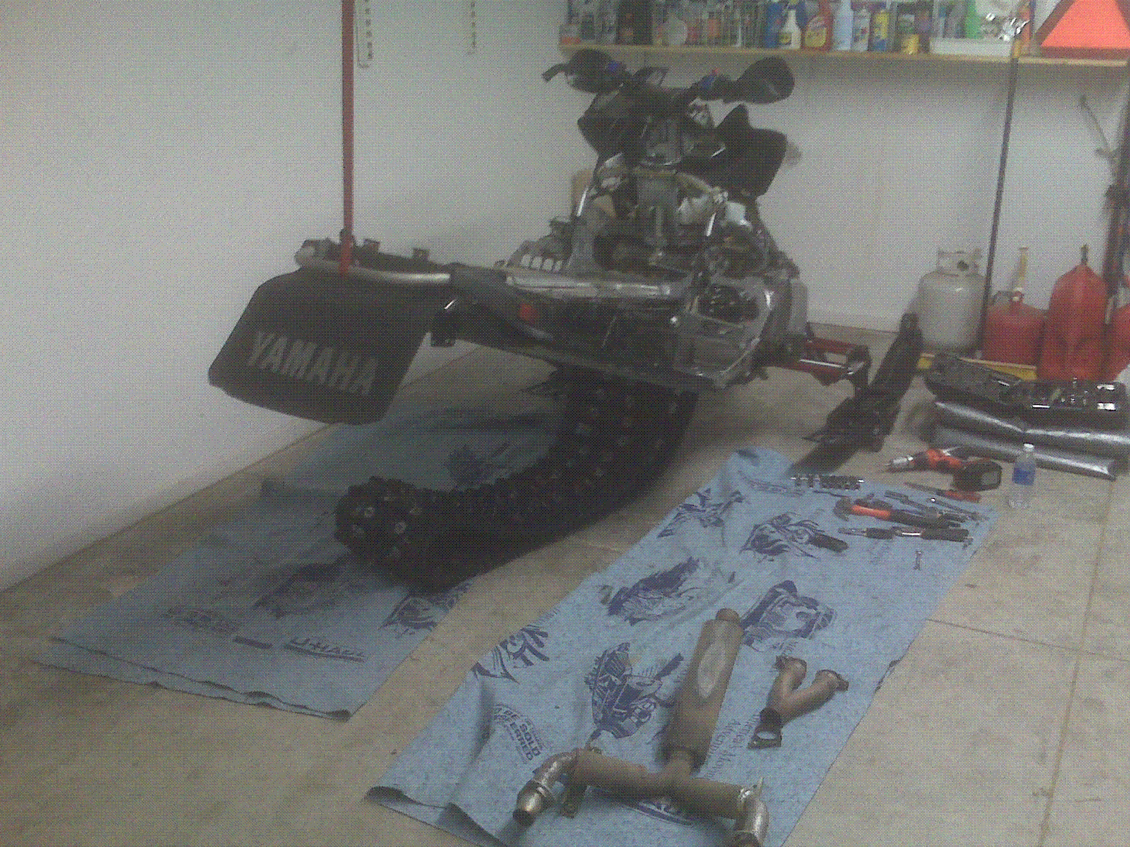

Lets the games begin: Spring project started: 3500 miles
List of PM activities:
1. Repack hauck exhaust
2. Check suspension;
a. A few bogie wheels need replacing, Slydogs
b. Add bigboy spring, sending shock to Fix powersports
c. lube all points
3. Change driveshaft bearing, lubed a few times i.e. the past seasons, easy access with suspension out, will change
4. Check Y pipes and gaskets; gaskets need replacing-worn with a little life left- caught early with no issues to the Y pipes, thank god.
5. The obvious PMs; all oils- engine and chain
Need assistance with Steering column!!!!! I have a loose steering column with a lot of play, anyone have any idea how to tighten the steering. Looked around but not sure where to start. I will check with my dealer but though I would ask on ty first.
See pics below.
