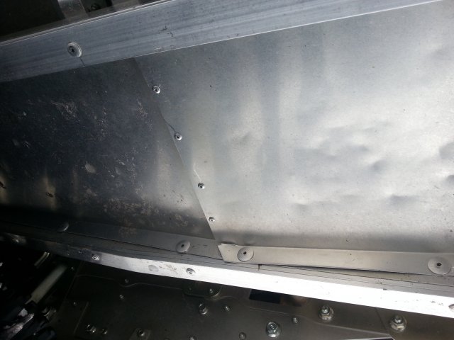

Grimm may very well be on the right track. Different skis, different track, studs, ice scratchers on one not the other? My scratchers cause a lot of snow dust, resulting in lots of ice. I know that the Nytros have addressed the issue with the block off plate for the muffler, but I haven't heard much about Apexes installing a plate. It would be easy enough to do if you still have the tunnel protectors.

I've installed block off plates, between the tunnel protectors, from the front of the muffler to the heat exchanger. Eliminates 1/2 the ice. Works well. Have ridden side by side with my buddy who has the same machine and compared. Have also done the same to my Nytro XTX and works.
