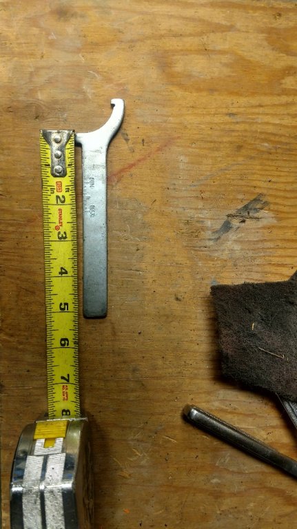

Hey guys I just got two control rod wrenches from BOP not knowing which one is for the Attak. The marks on one of them is almost half an inch closer to the open part of the wrench then the other. Which wrench would be the right wrench for the Attak skid ? I'm hoping someone has had a 121" and 1 36" and would know which wrench is correct.

Hey Winderallday! Thanx for the reply. I thought I read somewhere that the 136" had a different wrench . I got my wrenches from Travis. He wasn't sure so he sent me two wrenches that have the marks in different locations. The marks start about 1\5" different locations from each other. My main concern is having the control rod set properly so I don't damage it. I think I'll set it with the wrench that matches the wrench in your pic. Thanx again .
superfan75. This is the wrench from an 07 attack gt sorry in inches

Hey that's awesome, that is what mine came from, a 07 Attak GT. Thank you !!superfan75. This is the wrench from an 07 attack gt sorry in inchesView attachment 144231

I read somewhere the Vector wrench/gauge for setting transfer or control rod as some call it, is different than the Apex, so that could explain the different calibrated wrenches you have.
