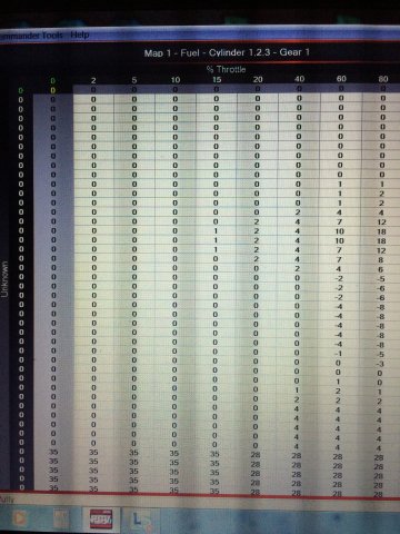

Finally seem to have everything enabled and working. Took my first ride, and accepted the trim values. I noticed that the base fuel table now shows the rpm values down the left column as "unknown" and instead of the 39 usual rows of a pre-auto tune map, there are 180??? The first 39 look normal, the rest do not ( lots of extreme values). Is this normal?
I have not see this before can you post a screen shot?
Sorry about the pic, laptop is offline...the row the 35 values start at is row 40, where a normal map would end at 10,000. Not sure if it's related, but in the advance/demote map portion of the software, the "target Afr tables" reads "invalid state". This is disconnected from the PCV, not sure if that matters. I did get trim values, and sled seemed to run good, so I think it was working.
Thats not right... where did you get the PCV from? Might have to call the help line... I have never seen that before.

Go into Map Tools and then into Advance and see what the RPM resolution is set to.
It's set to 250. Bought the PCV off of a Ty member, had been successfully used previously.

Reset the resolution to 250 and see if it comes back, if it dont something is not right.
