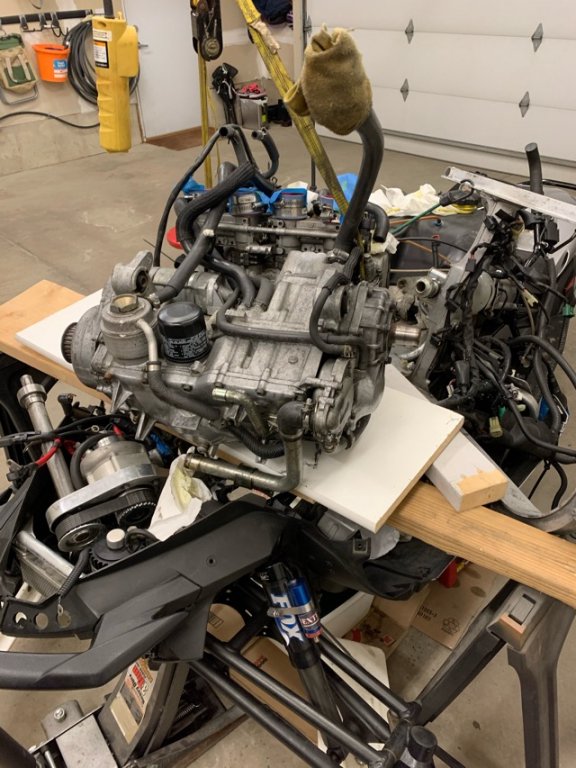

Engine back in! Upper steering gate is a milestone on these sleds. Both getting them off and back on. Put the clutch back on and will check alignment tomorrow. Should have it fired by weekend and do a test ride to make sure it’s all ok!
